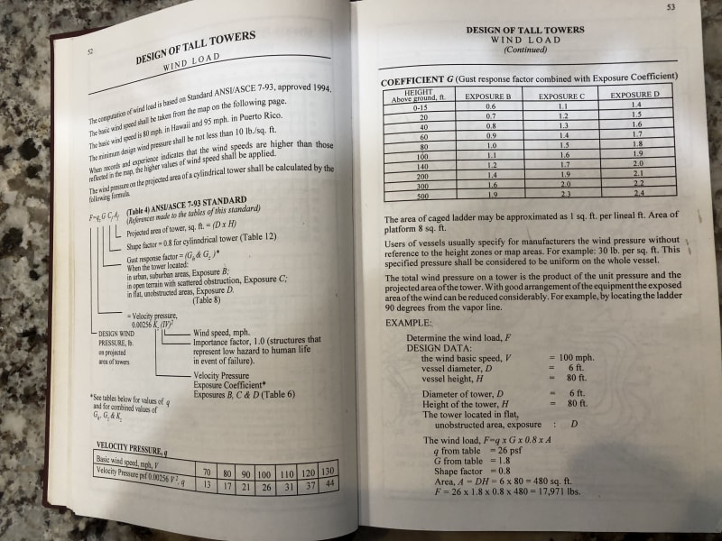

The ASCE Code has evolved over the years and so have the mechanical codes that reference that code for wind and earthquake loads.
Back when I first started design engineering 1984 the code for wind load was ASA A58.1 then became ASCE-7. In the early ASCE codes the wind load was just the theoretical wind pressure = V2/2g multiplied by other factors. The LFRD method I don't think even existed. The V2/2g pressure was multiplied by the shape factor including other factors to get the actual design load on a vessel or pipe. Shape factor for pressure vessels was 0.8 to account for such things as stairways and ladders etc., and for pure cylinders such as pipe was 0.6.
I remember now that somewhere along the way ASCE started including the shape factor in their basic wind loads when the LFRD method was introduced. Mechanical standards adjusted for this. I don't remember the specifics but somehow the different mechanical standards accounted for this in different ways. It was very confusing really to deal with. Programs such as Caesar still used the old method of having the shape factor multiplied by the theoretical velocity pressure.
Here is a pressure vessel calculation using shape factor around 1995 using 0.8 as shape factor:
