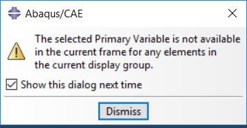

Ho FEA WAy,
My simulation for laser based and FDM based process is working well, creating frames and all, but to see the results with any Primary NT11 or Eactive state its giving an error, as attached below, I am using Abaqus/CAE 2019.
Check the generated input file and verify whether the field output is requested properly or not. Also check the output text files (msg, dat) for warning messages. They might explain why some variables are not saved.
