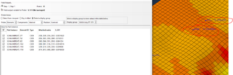

How to plot the chosen element values permanent for plot export
ShiningEngineer
Student
Oct 11, 2023
27
DE
Hello,
I know how to export the model as an image file.
But how can I permanently define the probe values in parallel via the query window so that they are also exported later?
As soon as I close the probe values window, the blue comments disappear.
Best regards and many thanks
You can't keep those labels after closing the Probe Values window so you would have to keep it open (and moved to the side) for the time of taking a screenshot of the model.
hello thanks for your answer, i used annotations now and filled the values as a text field in and export it afterwards
