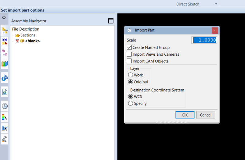

When importing a part
File ==>>import ==>> part.
Is it possible to import also the
Drawing. (Non master part)
Or in some other way.
Thank you very much.
yes. you can import NX drawings into NX parts using this method.
/ Tomas
Tomas thank you for the post.
This is the dialog I don't see something
about drawing.
Can you add additional info.
Thank you again.

I want to import the master and the
Non master parts . To a new master and
Non master parts.
Is this possible.
Thank you again.

But as I can import a part into another
Part.
I want to import the drawing part
into another drawing part.
Drawing part = non master part.
Is this possible.
Thank you.
Thank you.
I'm running nx11 manager.
I still do not understand the context.
can you illustrate ?
( when importing, it's "everything" and you will have to delete unwanted stuff after the import. There is no filtering on what to import.)

Hi Tomas
I create new blank part all its have
Is a part preferences.
No objects.
And then I import a part with different
part preferences.
And then I don't need to delete anything.
Thank you.
I believe Export Part gives you the options you're describing and allows you to choose a specific file to which to export or you can also choose to export to a new file. Import Part will import EVERYTHING into the existing part file (drawings, models, etc.).
