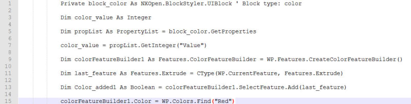

I have developped the following Block Styler
And I try to get the RGB color value to change feature color
But I didn't find the syntax at line 15 to put color_value instead of "Red"
Thanks in advance for your help
Regards
Didier Psaltopoulos
What You receive (values) when You pick a color and click OK? Maybe provide some code, it will be quicker to diagnose problem.
With best regards
Michael

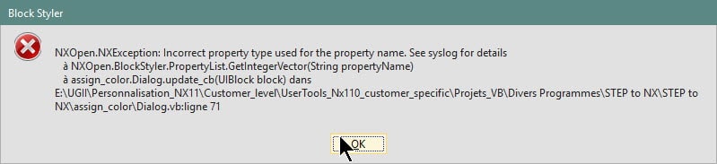

Thanks in advance for your help: find attached my code and my blockstyler
I have the following error message at line 71
Regards
Didier Psaltopoulos
The error is "Incorrect property type used for the property name"
the Second line in the error window shows
NXOpen.BlockStyler.PropertyList.GetIntegerVector(String propertyName)
your code at line 71 is
color_value = propList.GetInteger("Value")
at line 18, color_value is defined as Integer
the GetIntegerVector method returns Integer() (array of Integers)
I'm not sure why your code and the error are showing different methods (GetIntegerVector vs GetInteger).

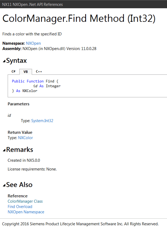

Did you try this
Code:
colorFeatureBuilder1.Color = WP.Colors.Find(color_value)
Hi apekas,
Thanks a lot, the link gave me the solution [thumbsup2]
here is the code with a bonus "change current feature color"
