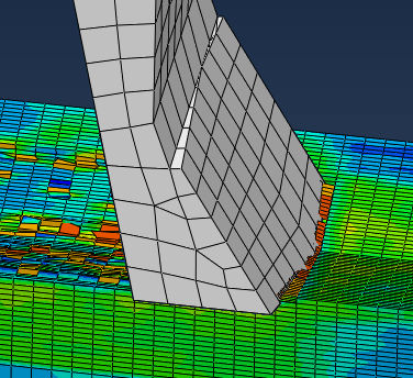

Hi all,
I am a new ABAQUS user and modeled a cutting process using dynamic explicit. The results make sense but it doesn't show the separated material and doesn't show the chip at all,I want to see the chip formation and I have already selected the STATUS but it doesn't work. can anyone help me with that? Thanks
In this scenario the tool works like a dozer or a moving wall and all elements that make contact with it are removed from mesh due to damage behavior. Try with sharp tool (rake angle > 0).
Thanks, I will try it again as you said
so sad, I have tried to run the model again after correcting the rake angle, but it seems that it didn't work either.
Maybe you should adjust the damage criteria. Also check some tutorials about cutting simulations in Abaaus, it’s a very common topic so you can easily find useful resources. If you carefully examine and recreate such example then you may find out what causes the problems in your case.
