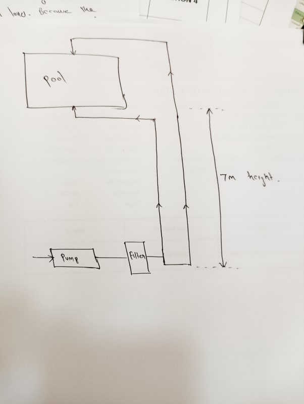

I was doing the head loss calculation for my swimming pool system for sizing suitable pump for filtration. Here I can use a maximum of 4" pipe. I calculated thr head requirement for my system. Here I have 7m static head and the friction losses around 13m. But I need to reduce the friction loss without increasing the pipe size.
If I add one more branch, I can reduce friction loss. Because the flow rate required should be reduced to half. But if I do so, how can I take the static head?. Is it 7m or do I need to consider it as 14m? Because 2 pipes are running vertically. Pls check the attachment.

Actually I have an over flow pool, where the overflowing water is falling to the tank through gravity. The tank is located in the pump room. So from the pump room I need to pump the water to the pool which is located 2 floor above ( 7m heigh) for making the pool overflow. I mentioned the static head as the 7m height, that is the vertical distance between water level in the tank and pool. I have a friction loss of 13m by considering all the pipe loss and minor losses including filter.
I thought, If I divert the pipe that going to the pool ( after filter ) into 2, I could've reduced the friction loss. But the vertical height that is 7m. TDH = friction loss + static head. So if I add 2 pipe, how can I take the static head. Is it 7m or 14 m..

What you need is the height from the water level in the tank ot the highest point of your pipe, if the outflow from the pipe is above the water level or the water level in the pool if your pipe connects into the pool below water level.
That static lift is the same if you have one pipe or 10 pipes.
If your flow is the same and you simply duplicate the pipes the same size, then your pressure drop from friction (not including the filter) will drop by a factor of 4. (half the velocity and friction is prop to velocity squared).
Getting absolute equal flow is next to impossible, but you won't be far away. Just recombine the tow pipes just before exit into the pool.
Your sketch is a bit basic so I'm not sure if one pipe is longer or goes to a different place as you haven't shown water level. If one pipe is even a bit longer or has more bends or is higher than the other then flow could be 75:25 if you're not careful.
Can yo draw a more exact one? with true levels and lengths? ANd the full system including return line to the tank?
Picture here as supplied
Static head remains at 7m.
Friction head drops by more than half, as friction is squared with velocity.
Looping the system by adding another equal diameter pipe halves the velocity.
Friction can drop to 1/4th that of a single pipe.

Had to make a coffee before posting, so that now just confirms LI answer.
