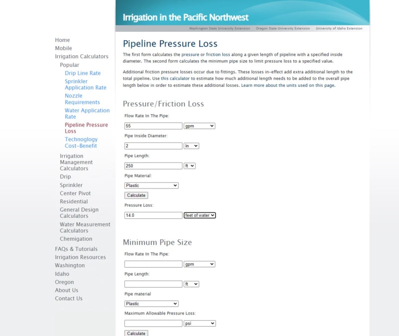

You can not assume the pump with a higher power motor has a higher discharge head. This really depends on the individual pump curve.
The Pumps - Affinity Laws provide generalizations that are useful for estimating the relative importance of the various aspects of pump selection.
The head loss shown by the pump is the resistance to flow from the piping. Pumps don't make head loss, they create flow.
For a small system use one of the online head loss calculators to calculate the headloss in the piping. Here is an example:
Add another 15% headloss for the miscellaneous fittings such as elbows and 10 psi for the swimming pool filter headloss.
Then, ask a pump supplier to supply a pump for the conditions (flow and headloss).
