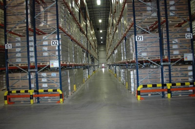

Hello,
I have problems with choosing Hazard nad Commodity class for following material:
Wooden Pallets consisting:
carton 8kg, pallet(wood) 18kg, foil 1,8kg, panels for suspended ceilings made from basalt wool (unflameable) 192kg, glue 1kg, mineral veil 4kg
pallets looks like below (but not inside racks):
Its solid-piled storage - 3 pallets top - max 4,5 storage in total.
How would you classify it?
I have choosen EH2 and commodity class III but now i have doubts. Since there is no flameable liquids it might be EH1, but there is no basalt wool in commodity tables.
Thank You in advance
Based on your description and reviewing the photo I would say class III commodity NOT EX as per NFPA 13. You can always go with class IV commodity just in case you missed something.
Looking at your storage again and the limited amount,
can you meet this from NFPA 13, 2013 ed.
3.9.1.18* Miscellaneous Storage. Storage that does not exceed 12 ft (3.66 m) in height, is incidental to another occupancy use group, does not constitute more than 10 percent of the building area or 4000 ft2 (372 m2) of the sprinklered area, whichever is greater, does not exceed 1000 ft2 (93 m2) in one pile or area, and is separated from other storage areas by at least 25 ft (7.62 m).
If so ordinary hazard Grp 2 as per Table 13.2.1 Discharge Criteria for Miscellaneous Storage Up to 12 ft (3.7 m) in Height
Forgive me. I forgot to add 4,5m.. so it doesn't meet 3.9.1.18* (it refers to 12ft storage tops- i have 3 pallets 3x1,5m=4,5m)
My first approach was to use CMDA method in Chapter 14- but still i have choosen CLASS III. Would you say it is wrong or it can stay like this? Risk of fire for those panels is very small.
Its dry system so i used 30% more of design area, and reduced density according to FIG. 14.2.4.3 (nfpa13,2016 edition).
I would agree with LCREP and go with Class IV at a minimum.

Sorry, but it looks like typical American approach :) I want to supress fire not to initiate A flood with ESFRs :) what a about this point: "5.6.3.3.2* A Class III commodity shall be permitted to contain a limited amount (5 percent
or less by weight of unexpanded plastic or 5 percent or less by volume of expanded plastic) of
Group A or Group B plastics"?
This is my case. Can i stay with class III and use CMDA? :)
Well, I guess the un-American approach is your choice. You do realize that CMDA is not intended to suppress but only control. That is why they are called CONTROL Mode Density Area sprinklers. If you want to suppress, then your route should be ESFR or Early SUPPRESSION Fast Response. So, you may want to re-define your intent.
