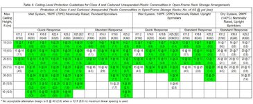

Got an FM job where we are dealing with FM Data Shhe 8-9 Table 8. Ceiling-Level Protection Guidelines for Class 4 and Cartoned Unexpanded Plastic Commodities in Open-Frame Rack Storage Arrangements.
The height of the building is 17'-6" at the highest point.
I would like to use the K25.2EC sprinklers where I need 6 heads discharging at 22 psi.
I know it is in the data sheets somewhere, I have actualy seen it before, but with six heads how many heads per line to I need open? My guess it is 3 per line but... can someone point out where the answer is in the data sheet? Been trying to find it for a few hours now....
Thank you.
