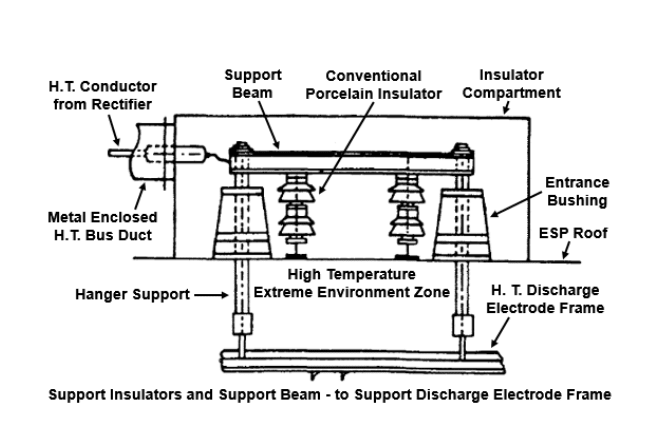

We have an electrostatic precipitator with field 1,2,3. We have a problem with field 2. The panel is tripping with UV. We did an open circuit test. The panel + transfo seems good. We suspect a short inside field 2. How can we do an insulation test to confirm this? While the plant is operating, there are charges on field 2. If we connect a megger on the field it might get damaged. Any idea if there is a special device which can test the insulation of electrostatic precipitator field?
The electrostatic precipitator is probably running at a much higher voltage than a megger can produce.
The first rest may be a visual inspection for arc marks or bridging at the support insulators.
To check the value of the insulation you may be able to use a high voltage test set, intended for testing high voltage cables.
But, if the test shows a bad insulator, you still have to locate the faulty insulator.
You may try switching the connections if that is easily possible.
That is swap the leads between field 1 and field 2.
That will rule out a faulty panel.

We cannot do an inspection now as the plant, boiler are operating. We wanted to do an insulation test to confirm the problem is inside the field. Then during next plant stoppage, we will do an inspection inside the field to locate the fault. The operating voltage of the ESP is around 55 kV.
I assume (With the dangers that that implies.) that you are feeding a lower voltage to 55 kV transformers to supply each field.
Insulation testing generally involves applying a high test voltage and monitoring the current.
You have a high voltage transformer applying a high voltage to the field and apparently the field is failing the test.
I repeat, if the panel and the transformer are good, then you have done a high voltage insulation test and the field has failed the test.
A test is normally done with a voltage higher than the normal operating voltage, but if the field is failing at operating voltage, there is no need for a higher voltage test.
I hope that your testing was done by disconnecting the final connection to the field so that the rectifiers were included in the panel and transformer test.

When entering EP penthouse, there must be some porcelain bushings, inspect them, may be there could be somthing.
Hi
We found a welding rod between the discharge and collecting plate electrodes. It fell down while maintenance work was done.
We removed it, energised the field. It is ok now.
