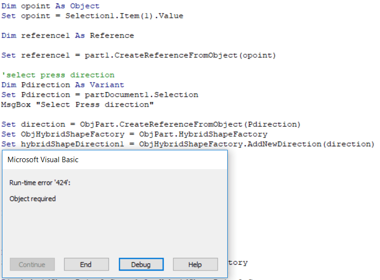

it says object required.
I have tried many times but its not working. please help.
Code:
Set PDirection = PartDocument1.Selection
This will make PDirection as Selection... not as the line you select

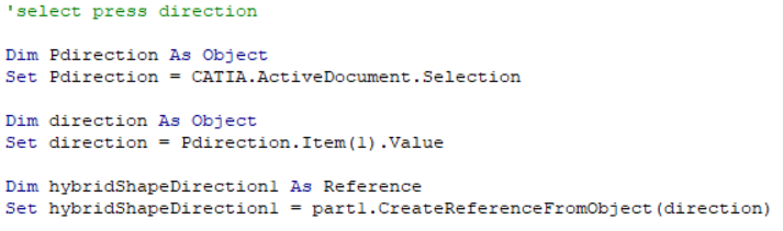

Look at how you define oPoint
Eric N.
Means like I define opoint , same I have to define line also.
i made now no error in giving direction,
but now line code showing error.

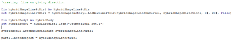

now you re passing the reference hybridShapeDirection1 instead of a direction when you're creating the linePtDir
you forgot to turn that ref into a direction using HSF.AddNewDirection(ref)

Dim hybridShapeLinePtDir1 As HybridShapeLinePtDir
Set hybridShapeLinePtDir1 = hybridShapeFactory1.AddNewLinePtDir(hybridShapePointOnCurve1, direction, 0#, 5#, False)
Dim hybridBody2 As HybridBody
Set hybridBody2 = hybridBodies1.Item("Geometrical Set.1")
hybridBody2.AppendHybridShape hybridShapeLinePtDir1
part1.InWorkObject = hybridShapeLinePtDir1
