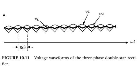

The double Y is there to give a 6 phase secondary output. One Y rotated 180º from the other (by inverting the polarity of each phase of the second Y winding) so you end up with a "6 pointed star" if you look at the secondary voltage phasors.
For starters, think about it as a 3-winding transformer (one HV and two LV). You will need the impedances, from the nameplate or the test report if available.
The interphase reactor, connected between the centers of the two Ys, is there to compensate (to some extent) the differences of voltages between both LV windings, wich helps with load sharing between them.
