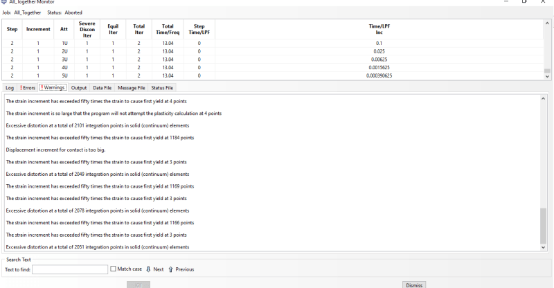

Hello Sir I got your point. but I have one more problem that after completion of my first step(Material comes down until glass) simulation stops. just start step 2 but it stops in 1 increment only can you just tell me how can I solve this error?
Are there any errors reported in the Job Monitor (or msg/dat files if you run this job from command line) ? If there are no errors what are the warnings reported ? Abaqus must somehow indicate the reason why analysis suddenly stops.
The error you get („Too many attempts made for this increment”) indicates some convergence issues but with no details. From all the warnings the most alarming are these referring to negative eigenvalues. Remaining warnings indicate large distortion. Instead of coupled temp-displacement I would try dynamic tem-disp explicit analysis step. Your simulation involves very large deformations when polymer is extruded (that’s why in previous threads I was advising you to use other methods such as SPH or CEL). It will be hard to have convergence. But you will have much higher chances with explicit solver.

Can you attach files generated from explicit analysis too ? And maybe a screen of job monitor.
These warnings about inactive DOFs are nothing to worry about. In this case they mean that you applied boundary condition on DOFs 4,5,6. These are rotational degrees of freedom which for solid elements are not used.

The message file is empty. Apparently solver only generated the dat file. However it features no errors even though there are some in the monitor. Can you show the picture of the job monitor again but this time with Errors tab open ? Or attach input file for this analysis if you can.
