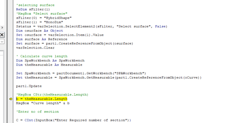

final update:
But still error.
Sub CATMain()
Dim partDocument1 As PartDocument
Set partDocument1 = CATIA.ActiveDocument
Dim part1 As Part
Set part1 = partDocument1.Part
Dim hybridBodies1 As HybridBodies
Set hybridBodies1 = part1.HybridBodies
Dim hybridBody1 As HybridBody
Set hybridBody1 = hybridBodies1.Item("Geometrical Set.1")
'selection of curve
Dim varSelection As Variant
Set varSelection = partDocument1.Selection
ReDim sFilter(1)
MsgBox "Select Curve"
sFilter(0) = "HybridShapeCurveExplicit"
sFilter(1) = "MonoDim"
Dim oCurve As Object
Set oCurve = varSelection.Item(1).Value
Dim reference2 As Reference
Set reference2 = part1.CreateReferenceFromObject(oCurve)
'selecting surface
Dim varSelection1 As Variant
Set varSelection1 = partDocument1.Selection
ReDim sFilter2(1)
MsgBox "Select surface"
sFilter2(0) = "HybridShape"
sFilter2(1) = "MonoDim"
sStatus2 = varSelection1.SelectElement2(sFilter2, "Select surface", False)
Dim osurface As Object
Set osurface = varSelection1.Item(1).Value
Dim surface As Reference
Set surface = part1.CreateReferenceFromObject(osurface)
' Calculate curve length
Dim SpaWorkbench As SpaWorkbench
Dim theMeasurable As Measurable
Set SpaWorkbench = partDocument1.GetWorkbench("SPAWorkbench")
Set theMeasurable = SpaWorkbench.GetMeasurable(part1.CreateReferenceFromObject(oCurve))
part1.Update
'MsgBox CStr(theMeasurable.Length)
B = theMeasurable.Length
MsgBox "Curve length" & B
'Enter no of section
C = CInt(InputBox("Enter Required number of section"))
D = B / C
'Selection of Point
Dim Selection1 As Object
Set Selection1 = CATIA.ActiveDocument.Selection
ReDim InputObjectType(0)
MsgBox "Select Point"
'InPutObjectType(0) = "CATPoint"
'InPutObjectType(0) = "AnyObject"
InputObjectType(0) = "Point"
Status = Selection1.SelectElement2(InputObjectType, "Select a point", False)
Dim opoint As Object
Set opoint = Selection1.Item(1).Value
Dim reference1 As Reference
Set reference1 = part1.CreateReferenceFromObject(opoint)

its not working:
stops here:
your code stop at selecting press direction , i think defining direction as object has some issue can you confirm it once again.
LWolf ,-I want to use line as direction but it's not working.
Please help.
