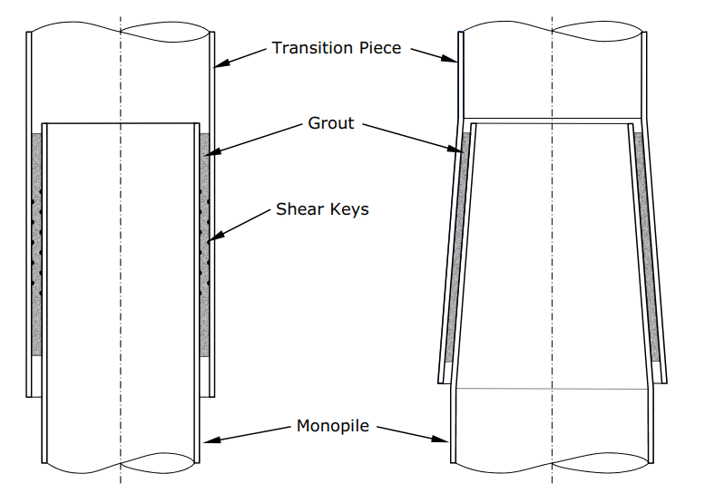

I am working on a grouted joint in offshore wind turbines, and I have been given load history which consists of loads and moments in the XYZ direction which change with time (both in magnitude and direction) to be applied to this model.
Cross section of a grouted joint in offshore wind turbine:
