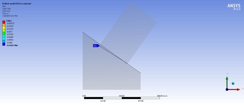

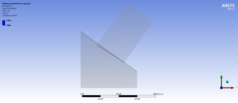

Thank you @L K. The bottom surface of upper trapezoidal block is contact surface while the slant face of the wedge shaped block is divided into 3 faces for creating joint edge (with the help of face split command). since there are 3 faces of wedge shaped block they are defined as target.
The results for penetration showing absolutely no values for the contact. Result for gap is showing -0.63 for the contact.
What should I derive from the results?
1.
2.
Please check above result images for Penetration (1) and Gap (2).

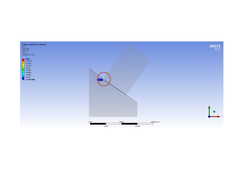

What is your deformation scale? Also feel free to upload a model, perhaps someone can have a look.

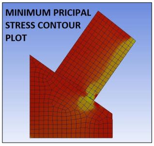

Erik Sir, the deformation scale is 350 times the original deformation. Sir, the deformation value is not the problem but the effect that these values producing on the stress concentration and the stress distribution is the main issue. I am attaching the stress contour plot with this message. Kindly check the image at the edge where penetration occurs.
The crushing is expected rather than the penetration.
How can I attach the file? Should I archive the file or should I attach .wbpz formatted file?
In the highlighted region (red circle) in the image below, we can see that the top part going through, this is of course due to the fact that you are exaggerating deformations. The only meaningful scale in nonlinear analysis is 1. With that setting I would expect the top part not to go through of course.
As for you second question, since you have sharp corners (on the opposite side also of the where I put the red circle) being pushed into the bottom part, and fixed at an edge also, that results in a stress singularity. If you want to capture stresses there you must put in fillets, and sort the joint restrain (not sure what it represents).

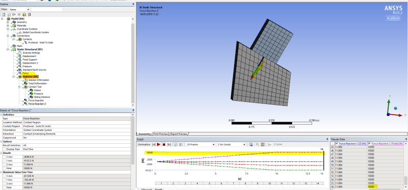

I have done a small example similar to yours, and based on all the above points and it works fine. The applied force is 10000N, and as seen that is reacted OK by the contact.
As for the surfaces to be parallel that is also important as it will make the contact much easier.
(I would make the wedge, and separately define a coordinate system that is aligned with the top wedge edge and on that edge (e.g., use make coordinate system from face and pick the wedge inclined face), when defining the top block, in that way they will be parallel, and touching.)
