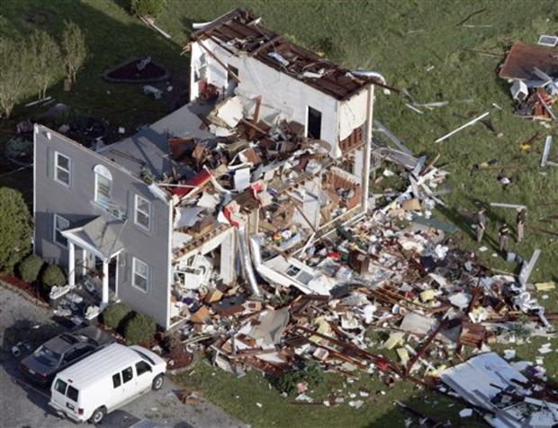

Today is the 15 anniversary of some shockingly strong and devastating tornadoes that hit the Hampton Roads region of Virginia, so the news had some footage and I spotted a house that makes me question why I even bother. The news reel showed the other side of the house, which I should point out looked exactly the same. Both exterior bearing walls were removed.
