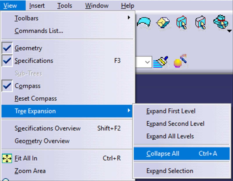

The Collapse All command will collapse your tree. I use this often and set a hotkey for it.
This will allow you to scroll much quicker.
Thank You for answear. Function collapse all I have known. Sub tree is interesting Idea for that.
