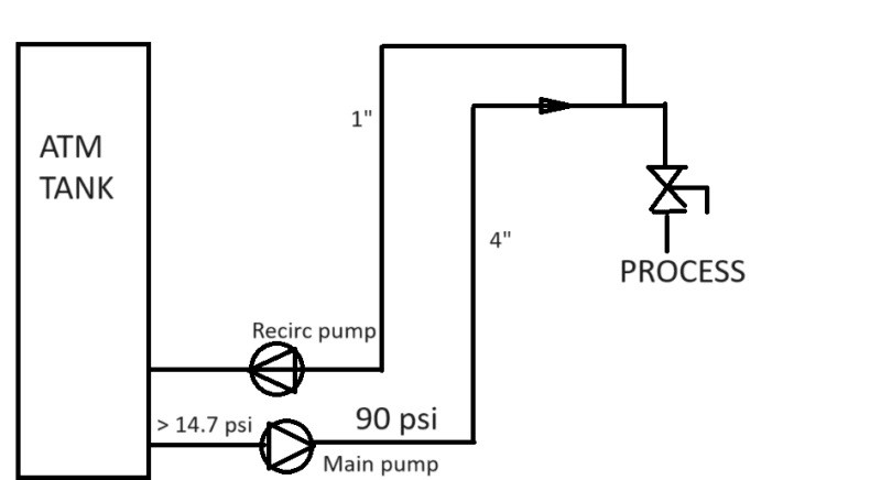

Here is a badly drawn picture to better explain myself.
Let's say the ball valve at the process is closed and the main pump is always pushing 90 psi.
The fact that the main line is connected to the atmospheric tank (at 14.7 psi) through the recirculation line would mean that the water just flow around because of the pressure difference right? So I would assume that a recirculation pump is not useful.
Now I agree that using the booster pump to just recirculate the water is overkill and not energy-efficient and as you said LittleInch it would not even work.
So I would need some kind of controls to start the booster pump when the pressure really drops a lot (i.e the process valve is open) and stop it when the pressure goes back to a certain threshold. Then I would start the recirculation pump to always have hot water in the main line.
The tricky part is that the pressure sensor for the booster pump has to be adjusted to take into account that the main line is always connected to the atmospheric tank, and so the pressure is never 90psi. Should I put a balancing valve on the recirc line to minimize the pressure drop?
I don't know if it makes more sense now, but I appreciate your feedbacks.

OK, badly drawn it might be but it is not correct.
Thinking about htis some more, your recirc pump really needs to be in parallel with and with NRVs to your main "booster" pumps.
where you have put it or even at the connection with the main line could easily lead to lack of NPSH for your pump as there is only atmospheric pressure plus what ever head difference there is between liquid level in the tank and the pump inlet flange.
your pressure at the bottom of the tank IS NOT 14.7psi, unless the level in the tank is always 10m above the exit?
I think you mean either 0.2 psig or 14.7 psia?
You seem to be confused about the atmospheric pressure thing and where you need to add differential head from the pump?
