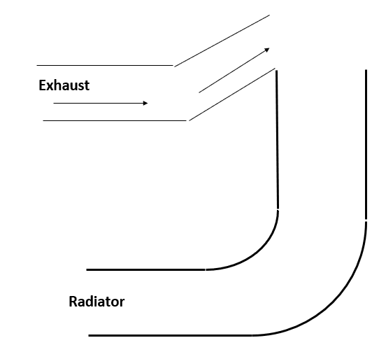

HI
The pressure drop in your design is very low. So, you can use the duct but I am not sure about the two other fans that you were talking about. It seems not necessary at all. However, you can use the exhaust of the Generator for helping the outlet air. It would be more effective. if you put the exhaust outlet perpendicular to the duct the exiting hot air help to vacuum in the duct to make more speed for the air which passes through the radiator.
please look at the below image.
Gholam Baghery: do you have actual experience with such layout? I mean an actually existing application that was approved by JHA?
I doubt mixing radiator air and engine exhaust is legal or recommended. If the radiator fan fails, exhaust could seep into the generator room. At least JHA could see it that way.
Also exhaust is corrosive, so the duct material and location where you can discharge it has different requirements. I also would run that idea by generator manufacturer what they think about the engine exhaust going through addl. duct paths.
Not saying it is impossible, but a lot to look into.

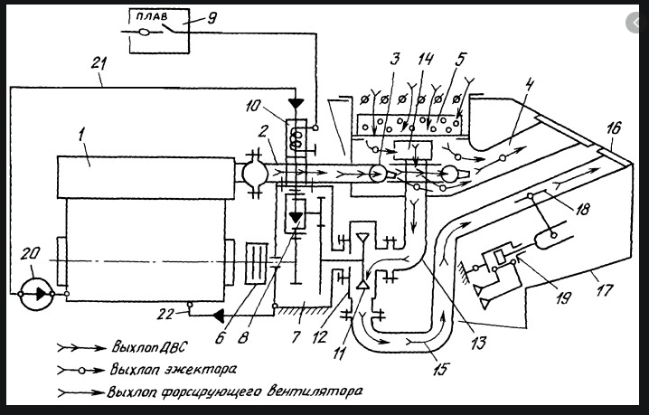

This type of design can be found in many military vehicles such as BMP1 and BMP2. Also, I used this type of cooling system in a 1.2 MW generator in Iraq during the Gulf War. The diesel engine of BMP armored personnel carriers does not have a rotating fan or turbine and has radiators and ejectors that work with this system. Look at the attached file.
I'm sure you are well aware that the diagram above is just an outline and should be designed to create a vacuum in the duct, and if the fans do not work, the exhaust path should create the necessary suction in the duct.
Regarding the corrosion of the exhaust smoke, you are right and it should be calculated to obtain the life span of it.
Gholam_Baghery: I think the OP inquired about application in a building, with the associated requirements. I don't doubt the physics of your suggestion. But it has to be approvable by JHA.
A design without fan is simpler and could potentially be more reliable. But it also would require approval by the generator manufacturer (if you want any warranty, or use it for emergency loads). The vehicles you talk about I assume came that way from the factory.
Hi
Thanks for your response. Yes, you are right, it works in the physics approach, however, it must be approved by JHA as well. I did not consider getting approved. Regarding the vehicle, it has made in 1970 and it is still being produced, but with many new weapons, but the engine and mechanical system are the same and it uses the exhaust smoke for cooling the radiator.
