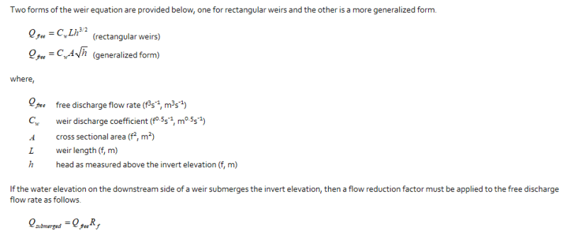

See below images for a rectangular horizontal weir. The other option is a circular horizontal weir.
That was helpful information for vertical weirs, but my problem is with horizontal weirs. Do you know the equation(s) for flow through horizontal weirs?

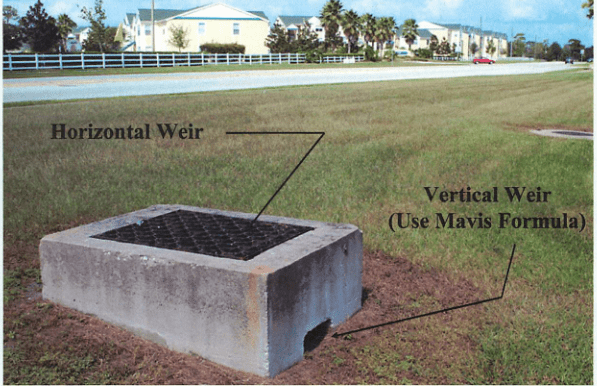

Sorry, I wasn't real clear on what I was trying to say. The situation you are dealing with is, as you initially referenced, what I would call an inlet rather than a weir. In this situation the inlet will behave like a weir until the water reaches a certain head level, then the inlet will act like an orifice. I think your software is trying to tell you this also. The equation I sent in the attachment is for the weir scenario, I would guess until the depth is about 1X to 1.5X the narrowest dimension of the inlet box before it starts to act like an orifice.
What I would normally do is treat the top of the inlet as four vertical weirs with end contractions up until the the flow rate starts to decrease instead of increase and then treat the opening area as an orifice. How about this approach? That works fine for square or rectangular inlets, but how do I calculate end contractions on a circular inlet? There is a circular stand pipe equation that can be used for that.

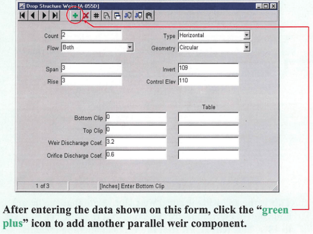

From ICPR 4 help:
Horizontal Weirs
A ditch bottom inlet is an example of a horizontal weir and behaves as a vertical sharp crested weir for lower heads, with the weir length equal to the perimeter of the inlet. As head builds up on the inlet, the opening can become overwhelmed at which point the opening behaves as an orifice, restricted by the opening area rather than the perimeter length.
A circular standpipe does not have end contractions...

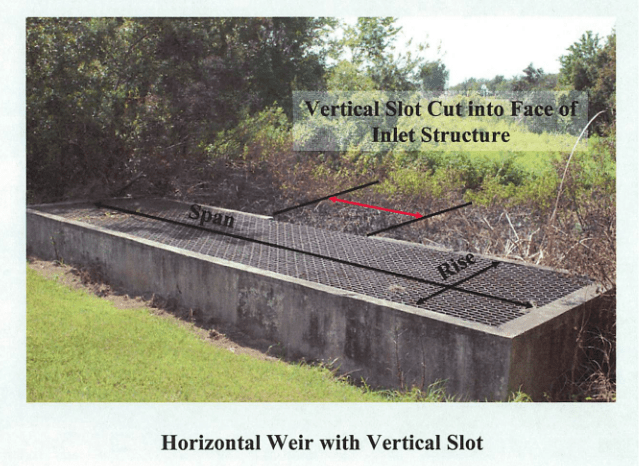

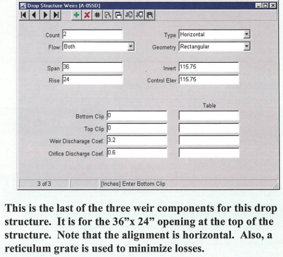

I think this is what I have been looking for:
Horizontal Weir Flow
For horizontal weirs, flow is first calculated as if the weir is vertical and rectangular, using the
perimeter of the weir as its length. Then a second calculation is made assuming orifice flow based
on the cross sectional area of the opening. ICPR then compares the two and takes the lesser value
as the controlling flow for the opening.
The only problem is that end contractions to not appear to be considered. If it is then maybe it is calculated using 2 end contractions since there is only one length.
And, for circular ditch bottom inlets the the same vertical weir equation is used with the perimeter being equal to the circumference. Is this correct?
KC,
I think what is going on in this situation is there are no end contractions for this condition since the rectangular drop inlet does not have side walls, essentially the weir width is the same width as the channel in which case there are no end contractions.
I would use the inside dimensions of the drop inlet for the weir length. This does make me wonder if the inside corners of the drop inlet impact the flow rate vs the same length of straight weir. I have not found any information related to this, likely negligible but one would think by now someone would have performed the experiment.
