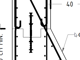

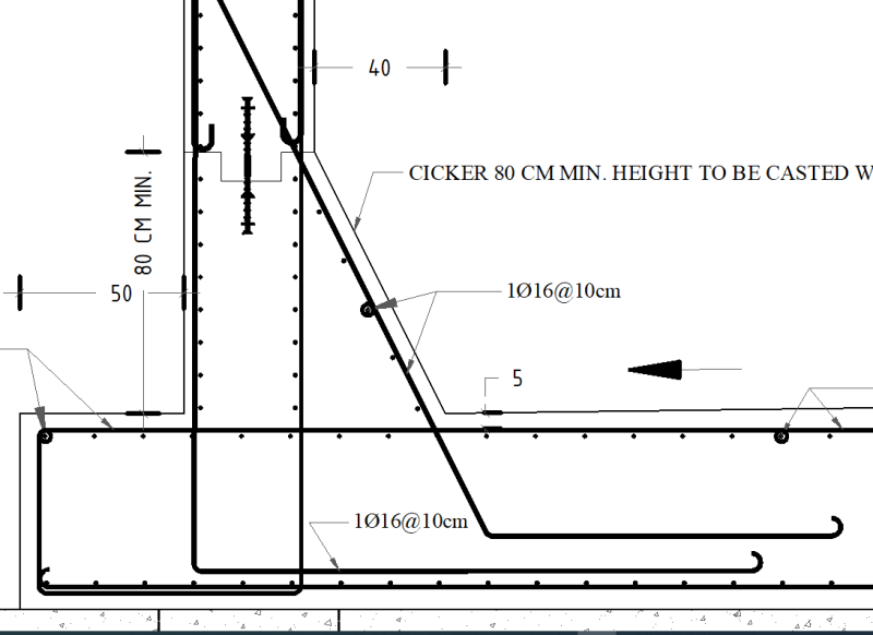

The images above should clarify the post.
I'm not sure but scaling this might uncover some issues. those 180-degree hooks (thanks dik) aren't that tight.
Plus, maybe it's different now, but I got scolded (nicely) by a fabricator a long time back about too many bends in a bar. They say that it takes up too much room in the shop floor. I'm thinking of those diagonals with the 180-degree hooks at their ends.
Jed, me, not dik. But you are welcome.
That drawing is indeed strange. Those 180 degree hooks, by scale, would not fit the definition given by any code of a hook. They are not long enough.
And yes, some of that would be a challenge on the bending shop floor.
Might just be my inexperience talking but I'm not sure what the long horizontal ends with hooks on those vertical bars are doing. A standard cog length would work just the same for a 90 degree bend, no?
Why yes, I do in fact have no idea what I'm talking about
I had the same question as Just Some Nerd. The diagonal cicker bars should only need to be extended at most the development length (straight)to prevent pullout. To prevent breakout, the diagonal cicker bars also need adequate embedment from the top of the footing.
I also don't understand the purpose of the hooks in the vertical bars above the construction joint. They should be lapped to the vertical bars from the lower stem wall, which is all they need to transfer the force across the joint. I don't see that the hooks there really accomplish anything.
