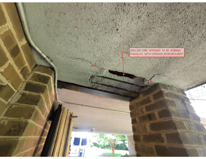

Thats what I thought. Did you see the picture? What am I looking at? Have to design some repairs to this deck.
I’m not sure that is repairable. The concrete looks to be very poor quality.
I'm inclined to agree with bones. It may not be repairable. That appears to be some substantial deterioration of the strands. I'm not seeing evidence of stirrups in that picture.

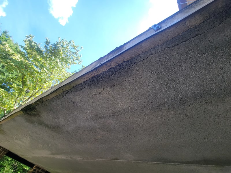

When I first looked at it, I thought they were strands too. And maybe they are but they would only be 4ft long strands as thats the length of the panel in that direction. I've never heard/seen of anything like that? And then the spacing is so tight, that would be something like 50 to 60 strands per panel. I attached another pic
 https://files.engineering.com/getfile.aspx?folder=4e9d129e-4b5f-4381-b9d4-69658c559158&file=20240710_155302.jpg
These panels are from the 70s. It almost looks like CMUs where its been pressed?
It could just be mild reinforcing I guess instead of pre-stressed strands. Sure is interesting. Most hollowcore panels I've seen are 4 feet wide or narrower. Yours appear to be far larger than that.
The planks are 4ft wide x 24 ft long and the exposed steel runs in the 4ft direction. I think I have seen this one other time but I can't for the life of me remember which project. Its definitely odd but there's got to be some strands in the 24ft direction or it wouldn't still be standing.

But the hollow core appear to be running parallel with the exposed reinforcement.
Hollow core panels are typically ONLY reinforced in the long direction (span direction), with no transverse rebar.
That picture is a little misleading-I should have said, the holes are not circular, more rectangular, the holes run lengthwise (24ft span direction). I found a post on here where someone mentions mild steel reinforced planks encountered on a roof deck, which if so would I guess explain the "stirrups" running in the transverse direction but like jayrod said, they almost look like strands. Either way, this picture shows the difference in materials. The topping slab is overpoured around the edges and you can see the comparison to what looks like CMU (aggregate and cement, no fines) planks.

What you have looks like "mild" reinforcement with some corrosion and spalling. It doesn't look like DOX plank (unless they put some parging on it that makes it look continuous on the bottom surface). Depending on what this is, shoring, ripping off all the garbage concrete, scraping/brushing to clear any laitance, wetting and bonding agent, concreting and fully grouting the cores with a bonding agent (where possible) or something similar that "feels" like overkill but isn't that much work given the small area, could be entertained.

I kind of wonder if the span direction is 24' and the plank is 4' wide. What's the depth. Alternately, is that some kind of "ceiling" with rebar in it for no particular reason and the true structure is above it? You could give it a go with a Profometer to see if you can find rebar going the other direction, but I wonder with that close a bar spacing going the other way it'll effectively block the rebar "above" it, if it's there.
I've seen mild reinforcement in older vintage HC plank, but in that case it was parallel to the strands at the edge of the plank.
I can't really envision a need for transverse reinforcement unless they had partial length voids and solid cast ends for higher shear capacity. In that case they might throw in some transverse bars in the solid end section for T&S reinforcement. But the photo seems to show the transverse bars under a void, so apparently it's not solid at the ends.
