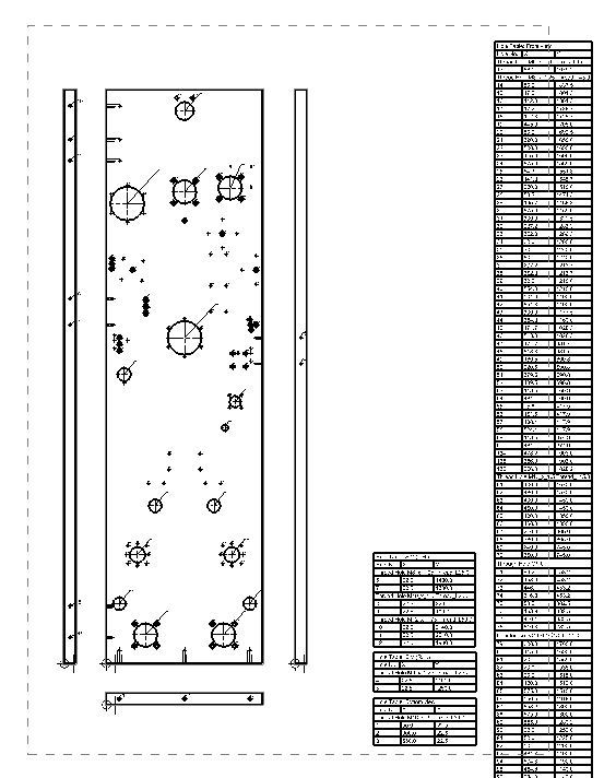

i have query in NX 11
i have part in nx as image,

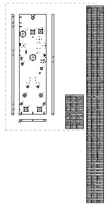

i give dimension via hole table, but in hole table the cells & columns are getting out of sheet,
my question is how to cover or fit column & raw of hole table in sheet, how to do partition of column
i attached image of it
if anybody idea for it, please share it

Hoover over the table and when the whole one set of table is highlighted/selected RMB and select "Settings"
Then change value in: Settings-> Common -> Section -> Maximum Height (=less than sheet height)
