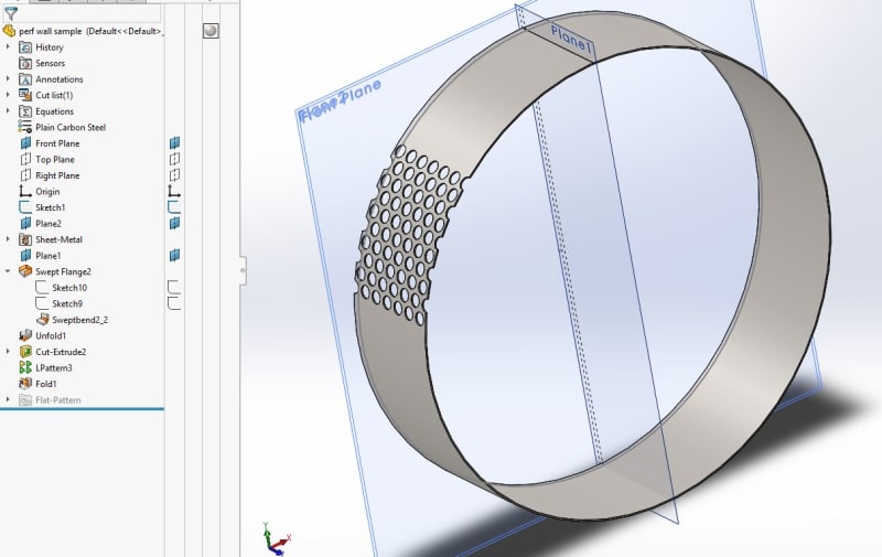

If the belt is in a form such that you can flatten it, you can flatten it, put the holes in and then unflatten. See attached.
> insert > sheet metal >
Swept flg - single line for profile, sweep path is belt path w/ small break, profile begins at break endpoint
Unfold- fixed face has endpoint on it for convenience, collect all bends
hole is just ext cut
linear pattern, edge for direction, specify pitch
insert > sheet metal > fold - same fixed face, collect all bends
all done.

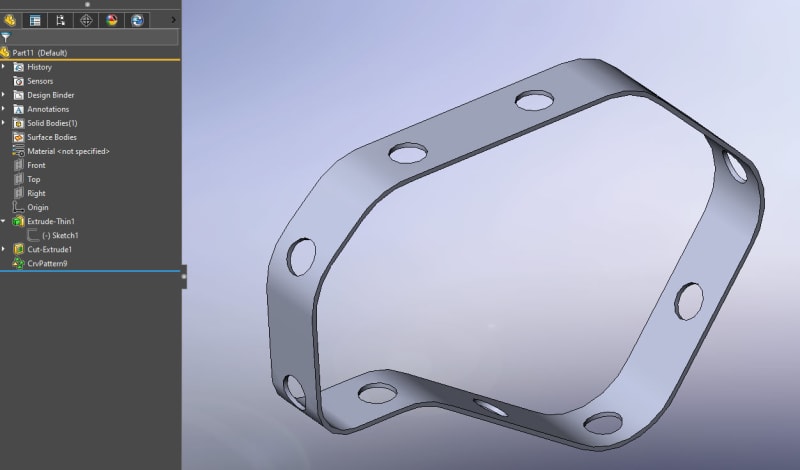

^, So to be clear, does the hole pattern follow the a line around the belt? I was unaware it would do that. Edit: that's right holes in thin parts will follow a local normal IIRC.
Hi, S-eng:
Sheet metal approach suggested by moon161 is a good approach. If you don't like it, you can try to use "Curve driven pattern" with HoleWizard command.
