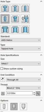

Not sure if others have seen this, but this has been going on for awhile so maybe someone knows of a solution. The Hole Callout does not automatically update when there is a change in the model Hole Wizard and drawing is not open? Here is a description from the Solidworks Forum with this exact issue:
If a change in the model hole wizard is made without the drawing open, then the hole callout dimension will not update correctly. Here is an example what I mean
-created a 4"x3".75" thick plate with a M4 thread with standard depth and save part
-create a drawing and dimension with hole callout
-save and close the drawing
-change the thread end condition to thru all and thread depth to Blind 2*DIA
-open the drawing and re-dimension with hole wizard, note the difference in the depth (THRU ALL vs 0.75" MIN)
-To go further on the bug, save and close the drawing
-Change the M4 thread to a counterbore with a .50" depth
-Open the drawing, both existing hole callout have not updated correctly, so re-dimension with hole callout to show correct changes
Included are screen shots and the example model and drawing.
I have to either have the drawing open when I change in model or re-dimension with hole callout, so is there a fix for this?
