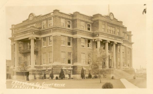

Just as follow up, found a picture that indicates this has been an issue, or not, for quite some time.
Also, another photo of a very similar courthouse of a couple years later construction, although from a different architect, that seems to have a similar although not quite as pronounced condition.

[li]In the photo I see dark rust stains creeping out of the bottom of the thick joint below the brick. It could very likely have been "repaired" by scraping out the existing rust and then packed with mortar. Which means that there may be a lot more corrosion behind this joint.[/li]
[li]Of course it looks like there are no weep holes or flashing which is often the case. So water could definitely be getting stuck behind the brick and corroding the shit out of the lintel. This same phenomenon can be occurring at both locations you mentioned resulting in similar conditions.[/li]
[li]I have seen obvious visible deflection of lintel angles like this before especially when there is a lot of rust buildup. So 2 inches sounds a little excessive but might very well be possible for the 20 foot length. But usually it accompanies some cracking and damage in the brick and mortar joints above also.[/li]
[li]I can't tell from the photo but it looks like at the near end the angle stops short of where it is supposed to be bearing on the remaining brick. Can't really tell without raking out some of the joint at the end. Do you know for sure whether it is a loose lintel bearing on brick on both sides or is it a shelf angle attached to the structure behind it?[/li]
[li]The thick joint below the brick almost looks like it could be soft caulked joint. Are you sure it's a hard mortar joint?[/li]
[/ol]
In either case, the thick joint should be raked out to observe conditions behind the joint. If you find a lot of rust, it's worth remove a couple bricks to investigate further. If it is rust related and there are no weep holes or flashing anywhere, this would be a bitch to eliminate the water causing the rust. I'm involved in project right now where we're removing several courses of brick for the entire length of the building to install new weep holes and flashing. There was a lot of movement and cracking in the brick for that project though so it's different from your case where the brick doesn't seem to be too cracked up.
