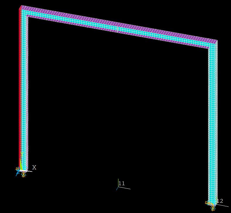

Hello lovely eng-tips-forum,
i would like to model a 2-joint frame with hinged supports. The supports are supposed to be surfaces. With the help of MPC184 I connect each node of the supports with a masternode and apply boundary conditions to the masternode.
Unfortunately the nonlinear calculation aborts and following warning appears:
"A boundary condition has been applied on 3 degrees of freedom of the
nodes belonging to the constraint element(MPC184) 2. It is likely
that the system may encounter solver difficulties due to
overconstraining."
I have uploaded two pictures of the support (MPC184 Spider).
Does anyone know how I can solve this problem?
Thanks in advance!
Julian
Can you post picture of complete model or problem definition? I guess you are over constraining the MPC element by applying boundary conditions at the common master node end. I assume you are specifying the revolute joint for MPC184 elements to simulate hinge support.
Could you specify the revolute joint as grounded and check? Probably the master node as grounded. See "MPC184" in help manual for more information.
Hey NRP99,
thanks for your answer! I will upload a picture of the model (at the end of the reply). I used rigid beam for the MPC184 elements, but I´ll try the revolute joint option. And yes, i think you are right that the applied boundary conditions at the master nodes are causing the problems. I have constrained the master nodes in all translational directions, so it should be 'grounded' right?
I'm also uploading my script if you want to take a look at it. I changed the applied surface pressure to be smaller so the nonlinear calculation doesn't abort, but in reality it will be much larger. Thanks in advance!
