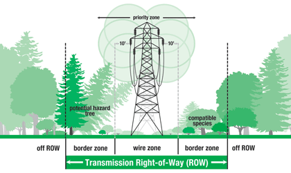

1) Is the term Rights of Way suitable for Underground transmissions as well (I.E. Cables), or there is a different technical term used? Almost similar to the Right of Way (ROW) is the easement. Any utility will require a legal ROW in case access and maintenance are required for the length of the installation.
2) What is considered typical distances worldwide, for both Overhead lines and underground cables, for different levels of Voltage? (for example, Voltages of 150-525 kV). There is not a universal ROW rule. That may change from country to country and even among regions such as urban or rural areas. A general guide of commonly used ROW is shown below in FT (values in parenthesis are in m).
3) Are there relevant standards or professional literature on the subject?. See figure below.
In urban areas, instead of dedicated utility ROW, the transmission lines are often installed in/adjacent to street ROW. In my area, any pole within the street ROW has to be relocated at utility expense if the city widens the street. If the utility places the lines on private easements adjacent to the street ROW, the city would have to pay to relocate the lines if the road is widened. Sometimes the steel pole foundations are placed on private property easements, with the wires overhanging the public street ROW.
In urban areas there can be conflicts between rights of adjacent land owners when cities allow zero-lot-line construction. For example, a utility is allowed to place a transmission line at the very edge of their property, and a land owner can place a building up to the edge of their property. However, OSHA requires 10+ feet of worker safety space between workers on the side of the building and a power line. It ends up being up the building developer to decide how close they can build while still allowing adequate room for cranes and scaffolding.
In the graphic cuky posted, the area labeled as border zone may have separate easement that allows the removal of tree hazards but does not allow any construction activity. In slang terms I would refer to the wire zone as ROW and the border zone as slashing/vegetation rights.

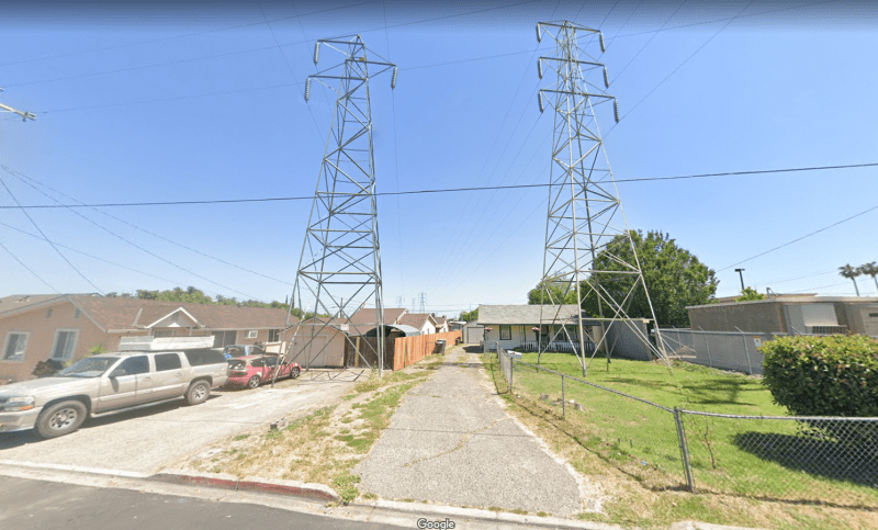

Depends where you are in the world.
Personally I wouldn't buyt this house, but it's there.

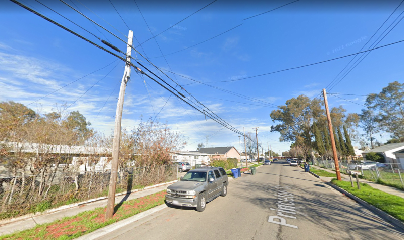

A couple of things. In the picture above, I would not want to live there, because it seems no one can park there cars correctly.
We use city/state easement for a good deal of our underground. Mostly for under the road placement, creek crossings, and through parks. It is called public right of way, and the city or state owns the land. In cities it is about the only way to find land without a house or buildings. We don't build electric lines above or below houses, or buildings.
We do put distribution lines in peoples backyards, or front yards, but most of those had been established when the land was developed, and is in a easement.
The backyard doesn't work so well, as people add fences, and out buildings and plant around transformers. To work on things we would need to remove that.
There is a line of homes with a 115kV line in the backyard, but those back into a major road, and the backyards are extra large. They still can't build below the lines, as building codes would not allow.

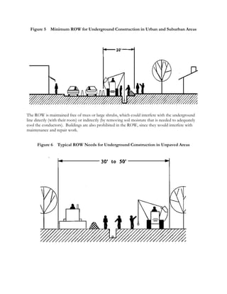

1) Is the term Rights of Way (ROW) suitable for Underground transmissions as well.. [/quote said:
Yes, the term ROW is applicable to UG transmission. The ROW width is less than the one used for OH transmission line. A good rule of thumb for a single circuit is a ROW width around 20-30 ft (~6.67-9.11m)
