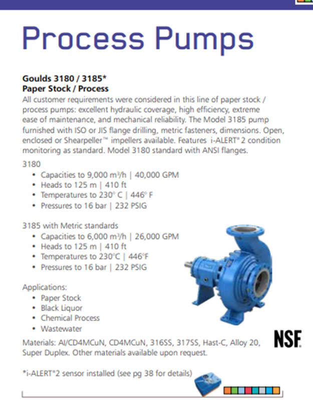

What's the pump inlet pressure?
If it's basically atmospheric then you probably need a can pump to generate the required NPSH.
There are many pumps that can do this but you need to supply more details.
