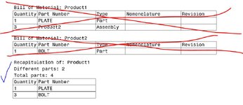

When I generate a BOM in a drawing, I need to be able to hide the Components, but also to show the Parts that are inside of these Components. I normally use Components as "folders" to organize the assemblies, so I don't want them to appear in the BOM.
In my case, the type of BOM must be "Top level", so using the "Summarized" type is not a solution.
As a simple example, in the following image, I would need the SUBASSEMBLY component not to appear in the BOM, and show the parts: PART (1x) and SCREW (4x).
Assuming you're using the Bill Of Material tool that comes with CATIA drafting;
Just use bottom table, and delete the upper tables that show the sub-components.
