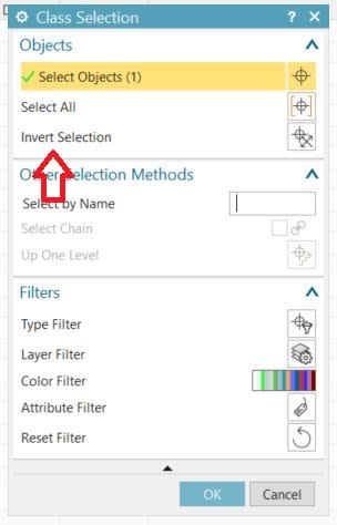

There's an "all but selected" function available, which u can use in addition to the "hide" function. I think that is a comfortable way to do it. Anyway, you can create a macro and apply to a custom button (that takes just 3 Minutes)^^
Best regards,
Simon
Select
Invert selection
Hide
