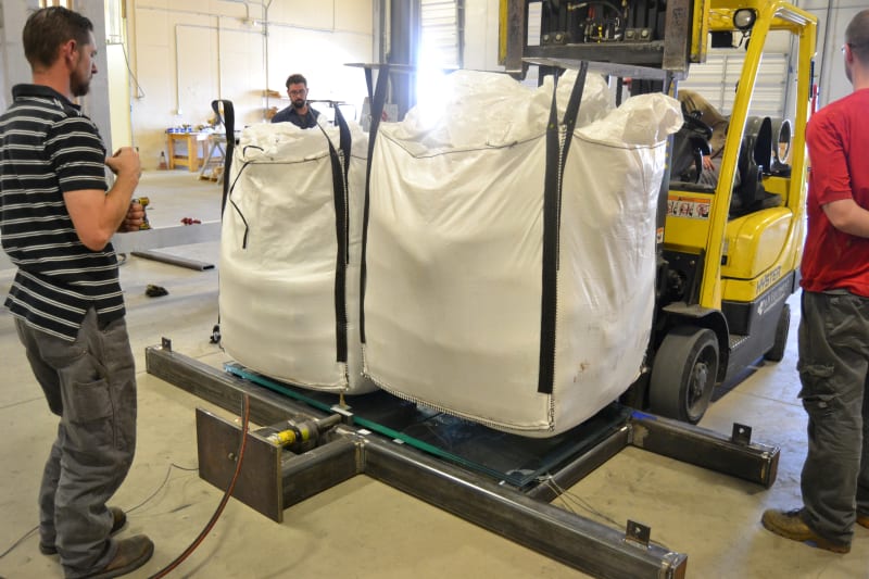

Actually i'm remembering these got value engineered out of our project at the last minute (whoops!), but they were designed to be approx 18"*72" and 2.5" thick. They span across the short dimension. From memory the axle load of a fire truck was like 50,000lb. We have done a ton of glass floors though, and even a glass slide 70 stories up. One of the biggest challenges as alluded to above is the scratch resistance, though there are solutions.
This is a test we did for a project a few years ago. At the base of this image is a piece of glass 3ft * 6ft * 1.25" thick, and each of these bags hanging from the forklift is filled with sandbags, approx 2500lb each. The sandbags used less than 20% of the structural capacity of the glass.
The little hydraulic jack at the bottom applies lateral loads of approx 5000lb.
I imagine that the picture showing a load test by using a forklift made me think that there are banks and various tellers of small businesses that stay late at nights that uses glass which are bullet resistant for protection. That is a path that may help you.
Brave guy, no safety glasses on.
