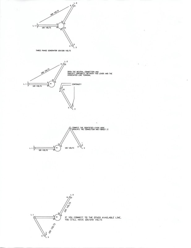

Why the zig-zag connection is the best easiest and quickest for field conversion from three phase to single phase.
Working in the field it is always a good day when the wire markings on a motor or generator are pristine.
Clean, clear and legible.
That is not always the case.
On older machines we encounter dirty wire tags. Faded wire tags. Missing wire tags. Tags that are illegible for any reason.
Reconnecting becomes a challenge.
The majority of three phase generators of the size that are most likely to be converted to single phase are wye connected for 120/208 Volts.
There are six windings.
There will be three line connections and a neutral connection in the motor JB.
Step one: Open the neutral connection.
Step two: With any type of continuity tester, identify the neutral ends of the windings from any line connection.
Step three: Connect those neutral ends to any other line connection.
Insulate that connection and forget it. You will never need it again.
Reconnect the other four neutral leads.
You are finished.
It doesn't matter which phase windings you start with.
It doesn't matter which line you connect to as long as the winding is not connected back on itself.
One line connection has been taped up and put aside.
You now have two line connections and a neutral connection.
From line to neutral to line you will have center tapped single phase with no phase displacement.
Where some numbers missing or illegible? Didn't matter.
The KISS principle reduced to the simplest.
