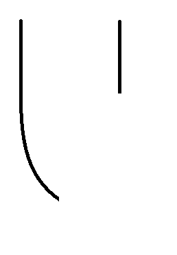

My apologies - I took a few days off for a much needed vacation. I much appreciate your pointing me in the direction of the above statements in Y14.5.1 - however I'm not sure I fully grasp how this covers all cases of opposed points without requiring the envelope principle. Take the case we have been discussing (a feature bounded by one short and one long side). If the portion of the long side which is unopposed begins to curve (like in the simplistic figure below), what prevents unlimited variation of this curved portion? It seems to me that without the envelope principle, there can always be found two solids Gl and Gm (for an external figure Hl = Gl and Hm = Gm) which satisfies those bullet points. Perhaps I'm missing something..

I really just meant that the third bullet point is still relevant in cases where the envelope principle doesn't apply. Something like this might be a good example, although it would be more dramatic with 150° of the cylindrical surface removed instead of 60°.
The envelope principle certainly makes a huge difference for features like OP's 50+/-0.25 width. Without it, the surface with unopposed elements can indeed behave as you show. I don't think you're missing anything.
One thing to keep in mind with these definitions is the need for the spines to be "reasonable". Unfortunately ASME Y14.5.1M-1994 doesn't appear to mention this at all. I think the draft for the next revision illustrates various ways to achieve unintended results with "unreasonable" spines, but doesn't provide a mathematical fix for the issue.
