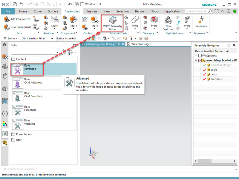

I recently updated NX7 to 1915. I am working in am assembly and wanted to Wave link some geometry from one part in the assembly to another part. I can't find the menu for it anywhere.
Found it, I had to "customize" the tool bar to add the commands. Looks like Wave is not on the Assembly toolbar by default.
That's a big jump !!!!
It's better to change the role to advanced.
By this way you will have all functions available.
Regards
Didier Psaltopoulos
Don't forget to use your Command Finder in the upper right of your NX screen
