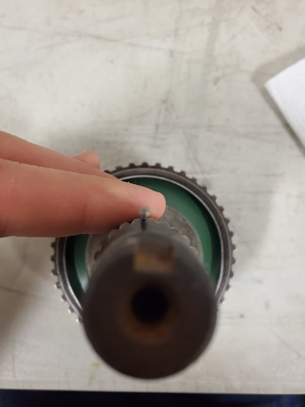

Hi everyone,
My first post here. I am a young engineer and just got my first job out of college as a design/reverse engineer for a aerospace company. Currently I am doing my own automotive projects on the side and having trouble identifying this spline. Long story short, I am retrofitting tapered roller bearings into a hub and spindle for a old Isuzu. I have virtually everything complete besides matching this spline standard. I've been beating my head on this part for a bit now, and would appreciate any insight. Also I can't find a copy of any JIS spline standards that don't cost upwards of +$350!
Pics attached too.
I am pretty sure it is JIS-D-2001 or JIS 1603 B. Although it is probably a JIS-D-2001 because its a cv shaft, meaning major diameter fit. I could be wrong about it being a JIS standard because my research points out that GM had a lot to do with building this car.
Spec/Dimensions I've found below via optical comparator:
Internal Spline
24 Teeth
Small ID (tip to tip): 0.975"
Big ID (root to root): 1.06"
Tip width : 0.027"
Root Width : 0.017"
Angle of tooth (paint drawing attached for clarification): 40-50 degrees
 https://files.engineering.com/getfile.aspx?folder=b99d5aca-da44-44ce-9934-2092f7a9e32a&file=20191210_071505.jpg

I have attached more pics of the spline too for reference.

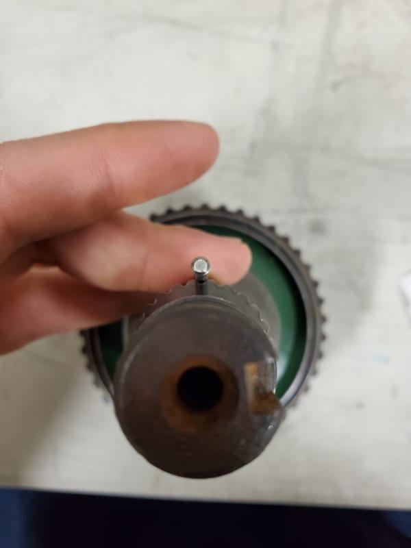

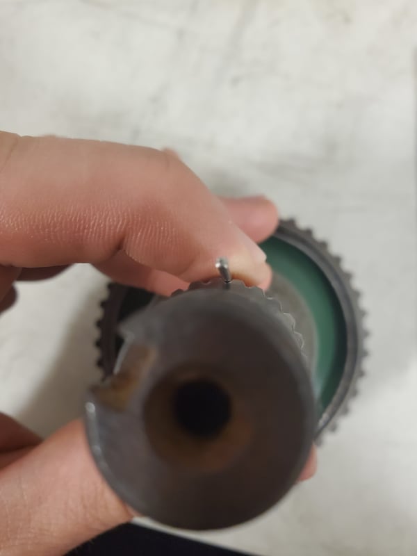

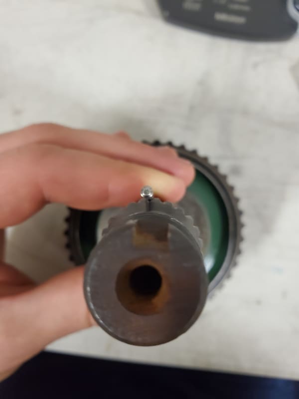

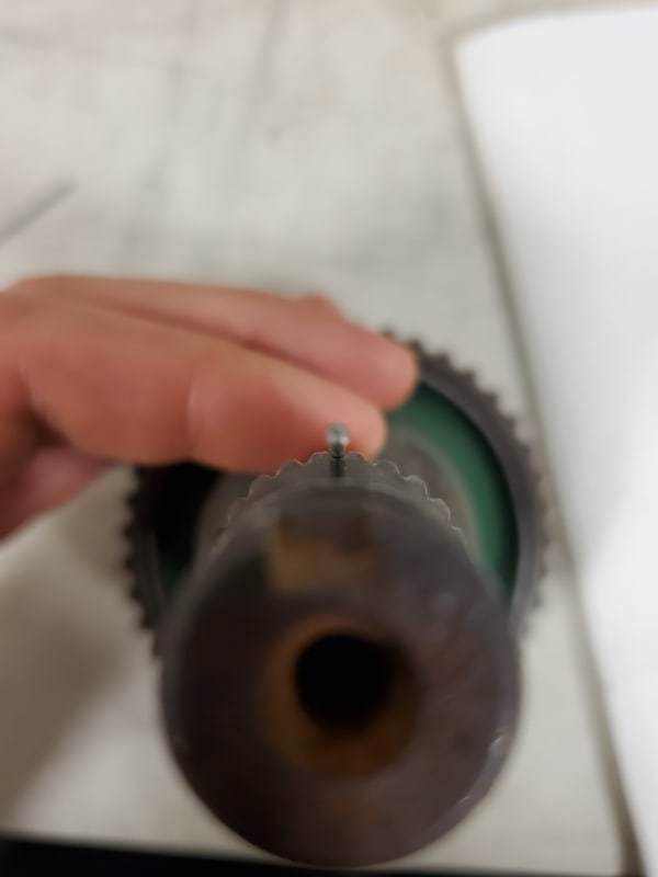

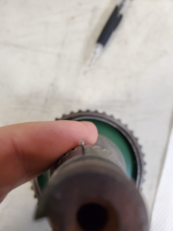

I got the CV shaft in (male mating spline) and did some over pine measurements. I will pop it on the vision system tomorrow to confirm #'s but I thought I'd share the raw data (+/- 0.00005"). Again any insight is greatly appreciated. I will crunch numbers asap and post findings here:
1) Pin one dia= .1199" , Pin two dia= .1199" --> 1.2246" across/ 1.22495" across
2) Pin one dia= .1080" , Pin two dia= .1079" --> 1.1973" across/ 1.19735" across
3) Pin one dia= .09200 , Pin two dia= .09200" --> 1.1605" across/ 1.1601" across
4) Pin one dia= .07190" , Pin two dia= .07195" --> 1.11320" across / same
5) Pin one dia= .06290" , Pin two dia= .06295" --> 1.09135" across/ same
6) Pin one dia= .05485", Pin two dia= .05485 --> 1.0726" across / 1.07300" across
7) Pin one dia= .04480" , Pin two dia= .04485" --> 1.04770" across/ same
Pictures:
1)
2)
3)
4)
5)
6)
7)
Thanks again everyone.

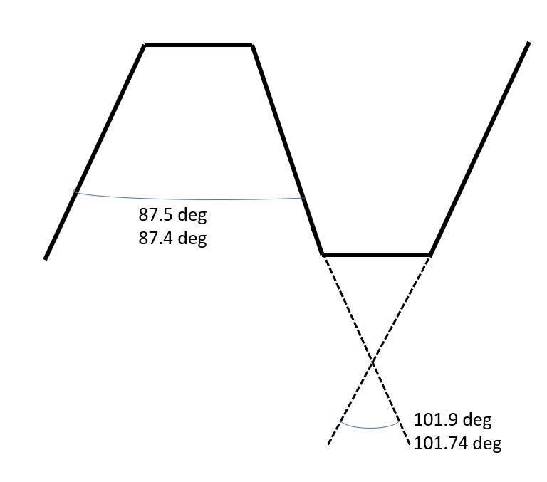

Got the flu and been sleeping feels like for 3-4 days straight. Anyways Thursday I remeasured the female spline on the vision system and comparator to match numbers; my initial measurements were off.
Diameter Root = 1.0627"
Diameter Tip = .9761"
Tip width = .0274" (across treated as straight line just for calculation sanity checks)
Root Width = .0168" (same; across treated as straight line)
Angles of teeth I obtained below in the figure:
As far as calculations go, I am going to go ahead and bite the bullet here, and look stupid on the internet. The only calcs I am confident with are with module and pressure angle. I didn't to mention that I am up to speed with gear terminology because I was also working on a custom gear project for my Mazda prior, however little reverse engineering was involved, yet.
PA = 45 degrees (calculated via male shaft physical measurement and CAD model female spline measurement to confirm via method here:
Circular pitch = 1.0194"... is it fair here to take the circle directly between Diameter Root = 1.0627" Diameter Tip = .9761" if PA is 45 degrees?
Module = .042475
As far as measurement over two pins; I am very lost here. I can't confidently follow the math in write ups online because most call of a known pitch, which I don't have. ANSI B92.1 is close to $100, and I am hesitant to buy another standard I'll maybe not need or use much (last time I spent $300+ on standards I barely needed for my gear project).
I am not asking to be spoon fed (unless you want to haha) but maybe a sample calc from the data I provided?
Also I was thinking since this spline most likely be EDM'ed, I can provide a drawing (similar to spigor provided above)and run a test cut on a 1/4" plate. Then I an test fit on the CV shaft and see if it has similar backlash and fit.
Sorry for the long post everyone. I am getting a little desperate as my business partner for this project seems to be loosing faith.
