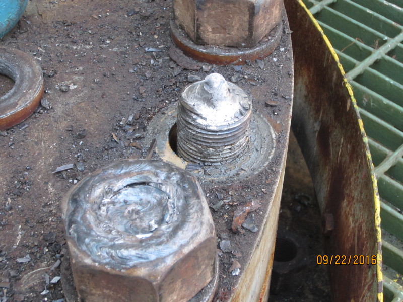

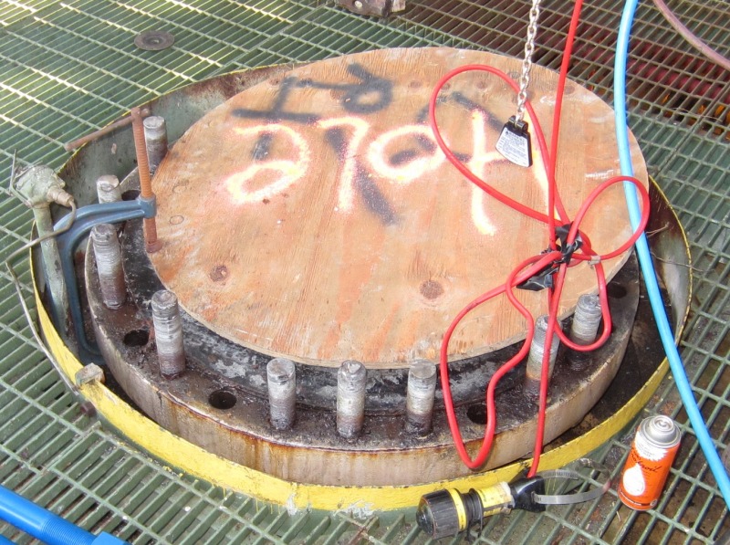

I have some reactors in a corrosive service. Heads are 30" 300# flanges. They were installed with studs. See attached photos
The corrosion between the stud shaft and flange itself locks it up tighter than whatever you can think of that is really damn tight. We can get both nuts to break free but that is actually not helpful as the stud is still "frozen" in place. Also note, the only way to get the stud out is to remove the bottom nut and pull the stud out from the top. We cannot go down because there is no clearance between the flange and vessel itself. Cutting isn't very useful either.
We tried to weld the top nuts to the studs to create what is effectively a bolt. Tack welds at first (didn't work) so we went back around and did the whole circumference. However we are actually shearing the welds with the big torque gun and still not breaking the stud loose. We've tried a ~3/8" interference pin in a hole drilled half and half into stud and nut, which worked for a few, but that is rolling over and not working in most. We tried a hole and pin though the side of the nut into the shaft (shear pin style) but that is shearing as well.

Covers are off, but we still have some frozen studs stuck in. A 20lb sledge hammer wielded by a mechanic self-proclaimed as "Thor" couldn't not get them to budge. They've been soaked in aerokroil constantly for a couple days now.
Going back, the holes will be cleaned out and the new PTFE coated bolting will be antiseized.

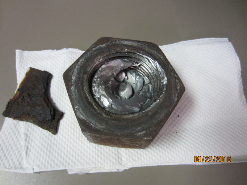

We had some "fun" with the RAD gun, here is what 8,000 ft-lbs will do to a 1-3/4 stud with the nut welded on

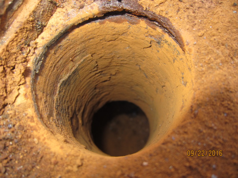

Here is inside one hole after stud removed (different flange but same vessel as above pics). This stud came out relatively easy compared to the ones pictured above.

looking at the holes, I'll ask if you are set up to power ream the holes clean?
byrdj
We are currently using a flapper wheel with a drill to clean out the holes. They just started on that this morning and from what I've seen so far it seems to be working well.
