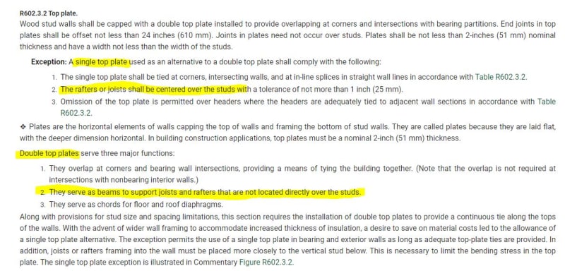

Building code only requires the joists to line up directly above the studs if there is a single layer top plate.
Your house has a double layer top plate, so the studs and joist do not need to line up. The double top plate serves as a beam to direct the joist load into the studs.
This was the only one I was aware of...

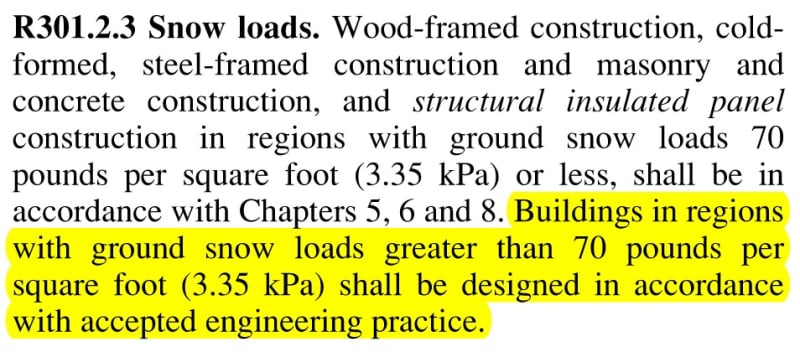

The prescriptive IRC Chapter 6 provisions that you cited do not appear to apply in this case because the snow loads are too high.
OP said the ground snow load is 321 psf.
OldDawgNewTricks is correct. The stated snow load sends you OUT of the IRC and into the IBC where you can't use traditional prescriptive rules of framing - and must design them accordingly.
OldDawg - Thank you for pointing that out! We don't even know what snow is in South East Texas, so I was not even thinking about it.
