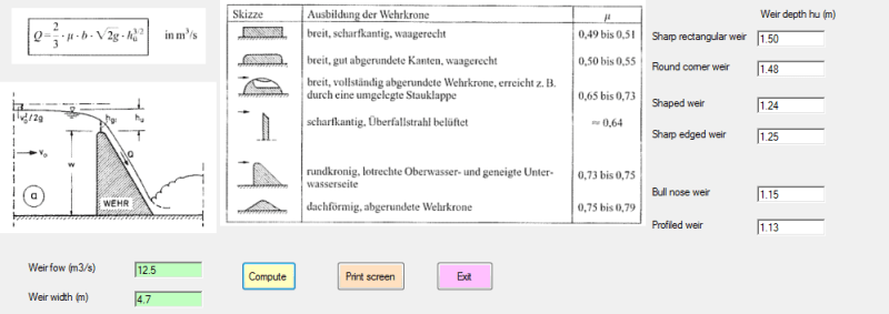

(a) The boiling effect of the seawater upstream of the weir is an indication the weir has been undersized. Air could be released if flow were fast and not properly streamlined. In general one needs a stilling basin upstream of the seal weir and the existing one does not seem to have no such consideration.
(b) Answer to "function of the weir within the outfall basin" - A seal weir is always provided to control the hydraulic system. The key requirement is to ensure the discharge upto and before the seal weir is "fully submerged" to effect a full bore flow. Therefore the pump for the discharge system has a guaranteed datum to work against. This is the most efficient way of arranging a discharge. If the flow changes between an open channel and full bore flow the pump will not operating at a steady duty point, energy will be wasted and the pump degrades over time.

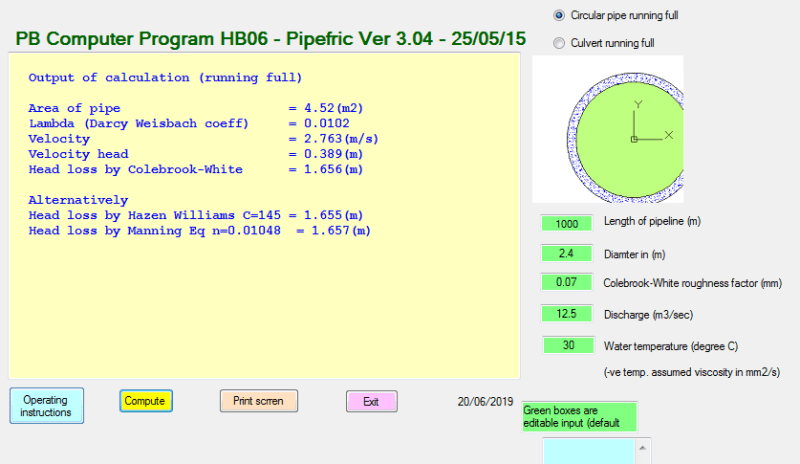

(c) An outfall system is always designed for the maximum sea level. The current one-year maximum of HHWL at 52.25m need to be revisited. I would find a nearby tide level gauge station and download at least the last 30 years records to get the highest possible level to check it against the local HAT and use whichever the higher.
(d) Answer to "ways to increase the driving head needed to overcome the high water level". This answer has two parts. Part 1 is water will have a level upstream of the weir determined by nature when the Froude number is 1. Nobody can change this.
Therefore if your existing weir is unchanged the water upstream of the weir has to be around 1.5m or probably higher due to the unsteadiness without the stilling basin provision. Thereafter if the water downstream the weir never rise above the weir level then your weir is adequate. If the system is inadequate the downstream level can rise above the weir level and the weir will have to work in a submerged condition.
At the moment with a HHWL at 52.25 there is a head difference of 57-52.25 = 4.75m between the seal weir and the highest high water level. Whether this is enough depends on the length, profile, condition and arrangement of the 2.6m Bonna pipe. I did a quick calc assuming the 2.6m pipe has 0.1m marine growth (so the effective diameter is 2.4m) over a distance of 1km (say) without any other other secondary losses using a nominal roughness factor and got 1.6m head loss overall.
Since the head difference is significantly higher therefore the flow in the 2.6m Bonna would be initially open channel and becomes full bore flow after passing the HHWL. Lots of air could be trapped in the 2.6m Bonna making the flow erratic and difficult to predict.
My gut feeling is the existing weir level should work for the 12.5m3/s or 45,000m/h flow.
I you raise the seal weir level you will change slightly the design of the pressurized system upstream and that can be considered if you have a submerged weir condition. However in your latest modification you now have two seal weirs and a common pit and that should improve things.

(a) If you put the new RTR pipe directly into the new common discharge pit it will not be pressurized to 0.2 bar as you expect. Nature will ensure the new common pit to have atmospheric pressure and a common water level even if you make the box airtight.
(b) The water level inside the new common pit will fluctuate in response to (but not correspond to) the daily tides and will not remain constant.
(c) Your current design is to place the new RTR pipe side by side to the existing 2.6m Bonna. Since from your own information the flow inside the Bonna will not be full bore (indicated by the hydraulic gradient). This implies the flow in the new RTR pipe will also be partially full. The consequence is the hydraulic system of the new RTR pipe will be compromised as you will not be able to know/control the head or level at the terminal end of the new RTR pipe.
(d) Your last solution will not work if the new RTR pipe is a pumped system. In such case a seal weir is needed and cam be installed inside the vented pit. If it is a gravity system with sufficient head and the the continuous movements of the interface between the full bore and open channel flow has no consequence to the system then it may work at the 15,000m3/h flow rate.
