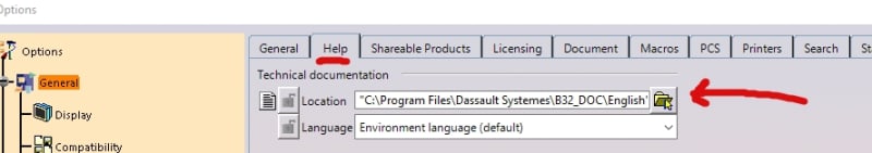

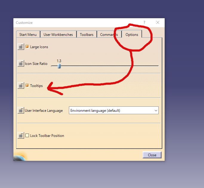

What do you mean by "mouse over command"?
Mouse over command (Tools → Customize)
Additionally under Help, there is a "What's This?" use that and it will bring you to the help documentation on that command if it has a link.
You do need to have the help file documentation installed and pointed to the location.
