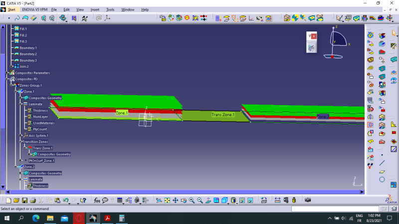

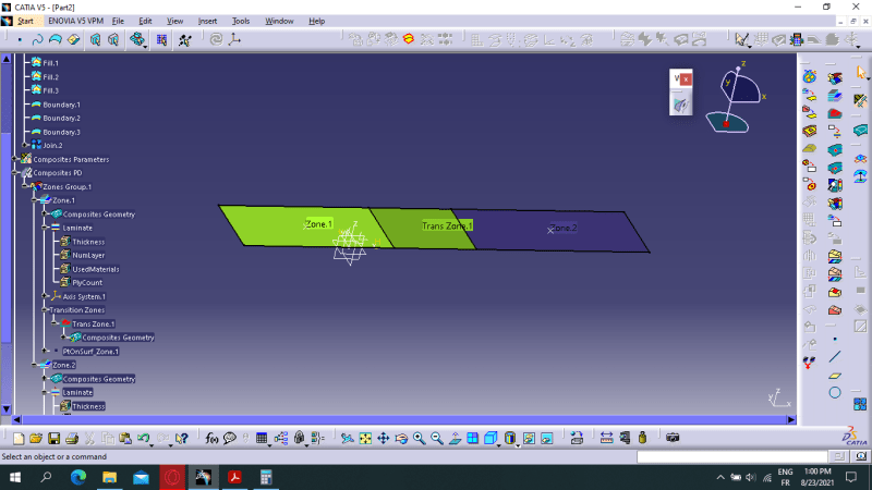

hello , first post here , i am working on a storage tank built with composite using catia v5r21
and i am encoutering some problems , i can't make transition zones between 2 zones , i searched in the internet but couldn't make it ,
here's what i do
1- i create a zones group
2- i create zones based on pre defined boundaries
3- i define a transition zone
but when i create plies and explode them i don't get any transition zone
