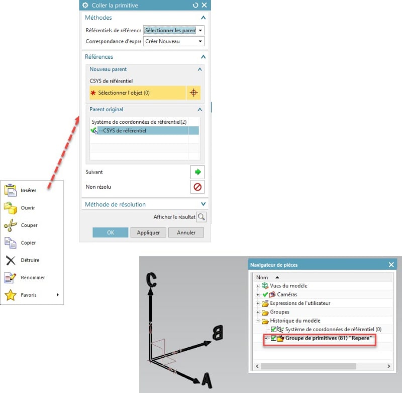

Hello everyone!
I'm new in the forum.
I have created manually a reuse library of Part. If I understand well this thread561-387070, It's not necessary to use this command DEFINE REUSABLE OBJECT & get this attribut REUSE_LIBRARY_OBJECT_TYPE : REUSE_IMPORT in he file.
So what is the aim of this attribute?
I'm using A standalone NX 12.0.2.9 MP5 version.
Thanks for your contribution
Hello Stéphane,

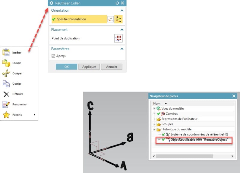

As I have explained to you in my own PSI-CAD forum, this attribut doesn't exist for your case.
We use this attribut in case of feature and the insertion result is different
REUSE_FEATURE
REUSE_IMPORT
Regards
