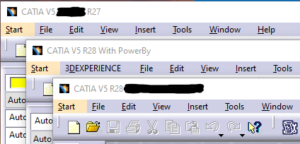

To the question about prevention: In my company we have done a few things to prevent this problem from occurring. (Yes, I've been bit by it also)
1) Launch your program with unique shortcuts and environments for each customer. This unique environment also includes a unique background image for said customer. The environment also includes an edited "Catia.catnls" file that states the program version in the Program Title section.
2) Use a PLM system to manage your files; and have your system track the CATIA version and prevent overwriting with the wrong version.
Thank you jackk for the useful input. I'll check this out.
Hello MarkAF, can you please expound regarding "unique shortcuts and environments"? Thank you so much.
Raul Berame, i assume MarkAF meant all environments that are provided by customer, if you work in automotive for some big brands, they have customized overlay to work on. So this overlay inlcudes unique shortcuts and environments so also you can set unique background. For e.g. you work for VW so if you open CATIA VWGRCLite - CATIA environment prepared to work on VW parts, you can set there background saying in the corner what release of CATIA is it.
