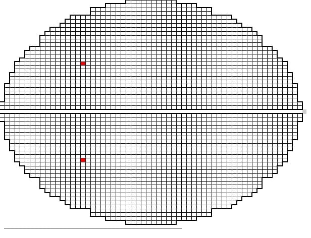

Dear guys.
Does anyone have experience in tube failure in heat exchangers type "U"?
Actually we have had a failure in a heat exchanger and we foudn that 1 tube was broken.
We are recovering all data from previous to event, however I dont lnow if you guys could recognize the failure with picture attached.

Where in the bundle is this? We need it located in e dimensions to be of any help.
Along with all of the other info that is missing.

Well.. the tube broken was found in almost the middle of exchanger.
Broken part was in straight side (not curve part).
"U" tubes were COLD BEND (was indicated in mill test certificate).
In a note (of mill test certificate) it is indicated that all U tubes are solution annealing at the U bend portion plus 300 mm of straight leg at min. 1110°C and 1235°C for 10 sec. And cooling by force air.

GD2.. No.. it was almost in the middle of tube length.
with the shape of failure (this "fish mouth" shape) that a kind guy said before, it is not possible to determine a possible source? I was searching into literature and short overheating seems like it had happened.

Likely impossible to get a sample of that tube without removing adjacent (outer row) tubes to gain access.
