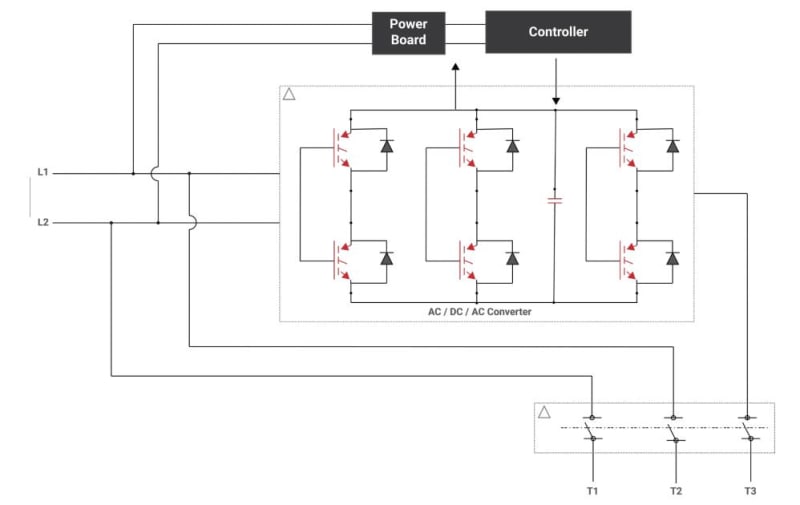

EGads!
I thought these inverters were sophisticated. They're cheap Charlestons.
How does that make 3 phase? Yes, it has three different phases but they aren't 120° apart. How could a rectifier front-end like this?
PhasePerfect or rather PhaseImperfect states, "Want to lower the voltage? Put a single buck in front of it."
Your guess is right Bill, seeing that schematic that makes sense.

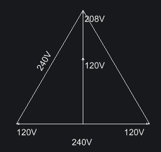

Food for thought:
How about three phase with one inverter?
A variation on the Scott transformation:
Given, L1, N, L2, 240 volts.
Have the inverter develop 208 Volts at 90 degrees and connect it to N.
If the inverter develops the same voltage as the supply voltage you can drive an auto-transformer with the inverter output and take your third phase from a 208 Volt tap. That way the output voltage will follow the input voltage.
Bill
Ohm's law
Not just a good idea;
It's the LAW!
That can make a perfectly good 3-phase "delta" source with phase-phase voltages equal to the original voltage. T1 and T2 are the base of the triangle and T3 is at the top. No neutral, no ability to feed single phase loads, but it should do fine for feeding a motor.
If you Feed a Scott transformer you may also have a three phase output with a groundable, symmetrical, neutral.

I bet that would work Bill one would have a heck of a time finding a robust enough inverter for, say, a 5hp motor.
David;
Are you refering to Bill suggest or the PhaseImperfect. Or, now that I think of it, both I guess, as they are almost identical.

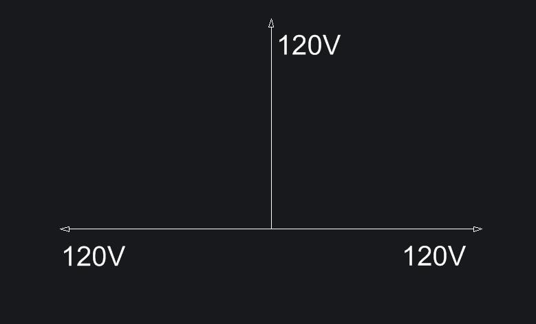

So you're both saying 3ph equipment is fine with 90°-90°-90° power?
Keith Cress
kcress -
If the two horizontals are 120 then the vertical is 208.
Using a delta-wye transformer is what many inverter systems I see do. The transformer also forms part of the filtering for the harminics.
What David said.
That is why I suggested using an auto-transformer for the 90 degree inverter output.
240 Volts in to the auto-transformer with a tap at 208 volts.

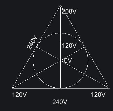

Well I'll be...
Still not clear on how a load sees this as okay. What is a bridge rectifier seeing? Is one diode.. um. .
So the synthesized OV point is there?
