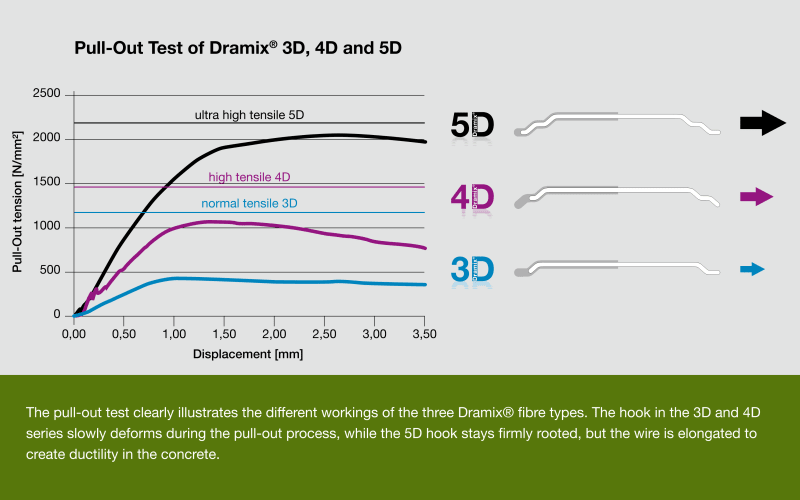

In an area of concrete where the tensile strain is greater than .025, the fibre is assumed to provide 0 tension force. So it is assumed to not exist. In a slab with minimum reinforcement, that would mean that there is no tension capacity from fibre for about 60% (original post 40% was measured from the compression face) of the depth of the section from the tension face. Anything greater than about 15% fibre replacement will not be able to achieve this. So 90% or full fibre replacement is not possible. This is based on the logic that above a strain of about this value, the fibres have completely debonded and provide 0 strength.
Secondly, AS3600 has provided a force/crack width profile that fibres have to comply with. Helix fibre did not comply with this in 2018. If they have not improved their fibre performance since then, it does not comply with AS3600 and the AS3600 rules cannot be used with it.

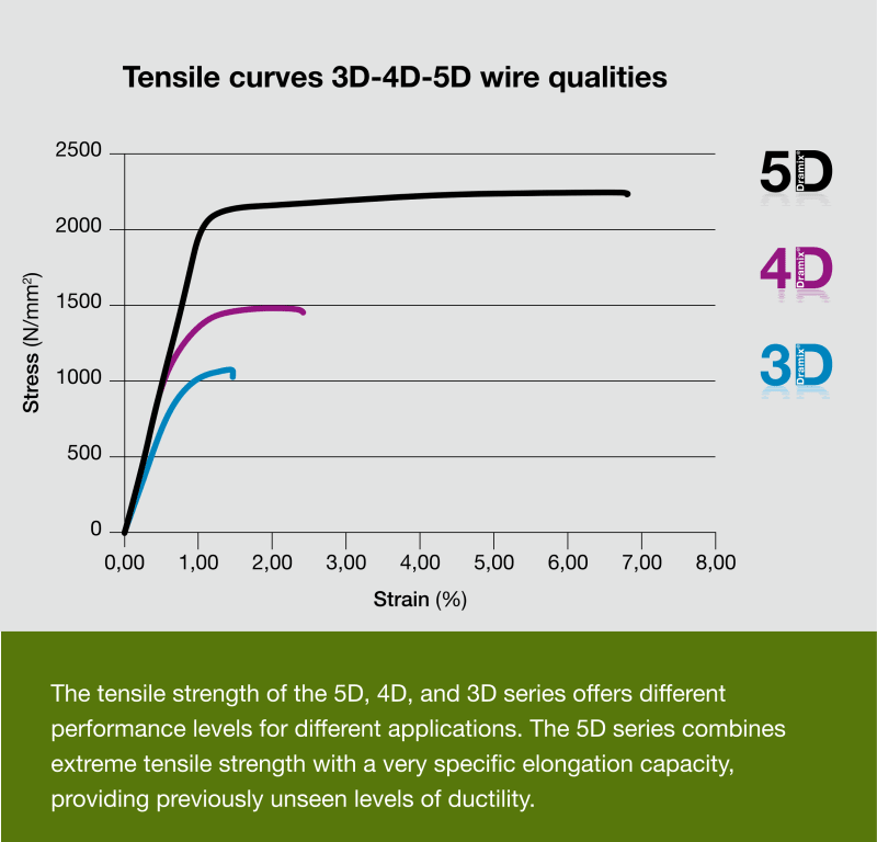

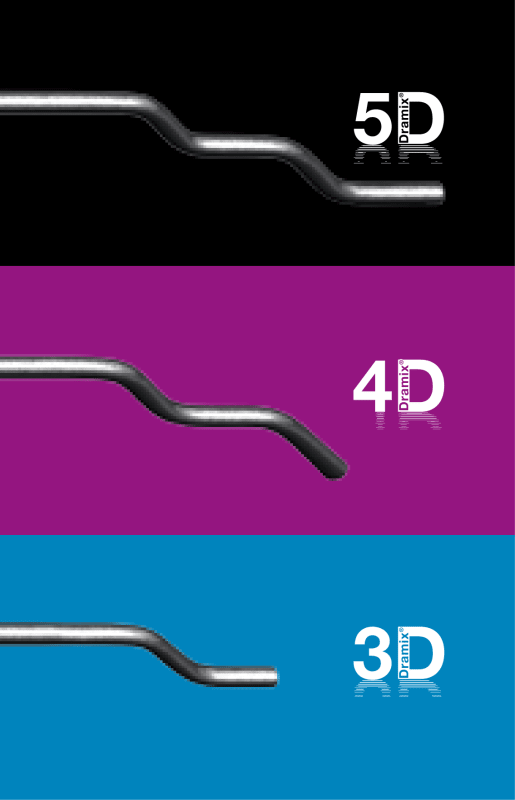

It really depends on the fibres, fibres with significant ductility do exist. For example dramix 5D fibres. Your typical straight fibres do not stand a chance.
