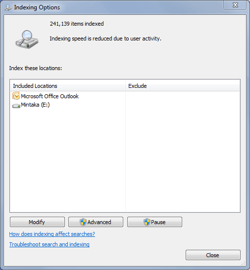

I accepted long ago that I will be using Windows for maybe the rest of my life, so it behooves me to learn to use it as effectively as possible.
Here's a screen-shot to match yours:
Sorry, I didn't notice the status text at the top of the window, not until you posted your screen-capture.
"Indexing speed is reduced due to user activity."

Which suggested this registry edit:
[ul][li]HKEY_LOCAL_MACHINE\SOFTWARE\Microsoft\Windows Search\Gathering Manager[/li]
[li]DisableBackoff = 1[/li][/ul]
The service (or the computer) has to be restarted after the registry change.
Later comments on the Microsoft forum recommend turning it back OFF again once it's done, or it could unnecessarily slow the whole system down.
I'll give this a try, but it means I have to hit "Submit" before I reboot.

"Indexing in progress..." Better than before.
To do this, the Regedit didn't work. Not sure what was really wrong but I suspect the HKEY was the WRONG key to edit for my version Windows 7.
Instead, after a bit more searching the 'net I found this: The indexing service should be stopped while the Group Policy setting is changed, then restarted for the change to take effect without a windows re-boot.
The indexing service is now reading through about a MB per second so maybe I will have access to better search results soon.

Bingo. The change to Group Policy fixed my problem.
To be specific about what I did for my Windows 7 system, rather than rely on an external link:
[ul]
[li]Windows Start, Run (or Win+R)[/li]
[li]type "gpedit.msc"[/li]
[li]Choose: Computer Configuration\Administrative Templates\Windows Components\Search[/li]
[li]Select "Disable indexer backoff", and set it to Enabled[/li]
[li]Type "services.msc"[/li]
[li]Scroll to "Windows Search"[/li]
[li]Right click and select "Restart"[/li]
[/ul]
I left the indexing to run overnight, and the results have improved remarkably. The search term "fracture toughness" turned up hundreds of documents. It also reveals how often I have duplicated or triplicated many documents, storing multiple copies in multiple subject folders. This avoids the Dewey/LC limitation that 3DDave mentioned above, and clearly I haven't handcuffed myself that way.
The indexing is still going, and in the time it's taken to write this, the "fracture toughness" search window has turned up two more items.
If I find that the indexing is slowing the system down later, this is fairly easy to toggle back to Disabled. Maybe toggle it back from time to time or if I make big additions to the library.
