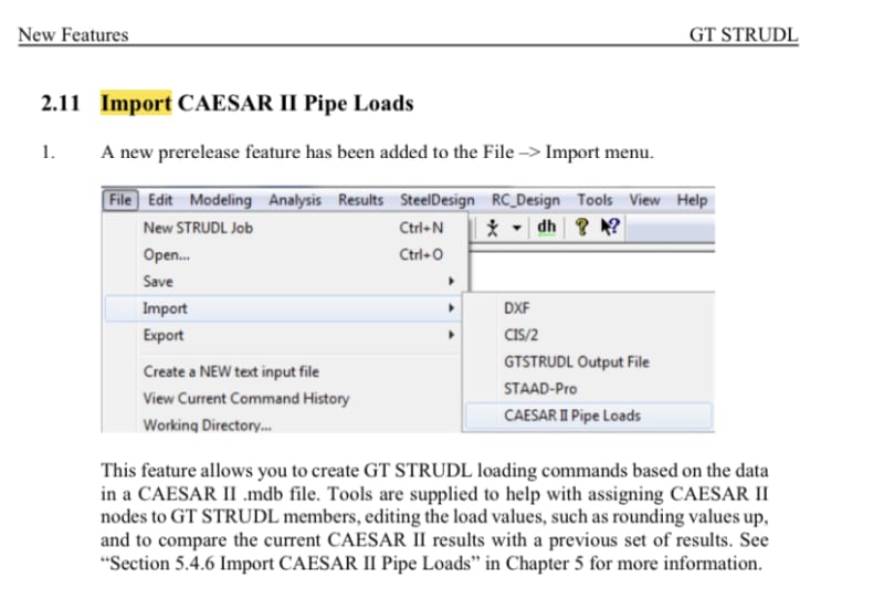

I recently happened to learn that there's GTSTRUDL by HEXAGON PPM, structual analysis software. If we go with GTSTRUDL, piping stress analysis results are imported by a click and they are modeled in SP3D by a click after structural modeling. Other options for sure would denifitely worth mention but the huddle is company's acceptance.

You may not get any takers on its pipe stress capability.
My mistake. I thought they were doing pipe stress, not importing loads. That should be just fine.
No worries, looks like a new feature just added. But I recall being able to import pipe support loads back in the day. May have been a CAESER to Frameworks to GTSTRUDL route.
